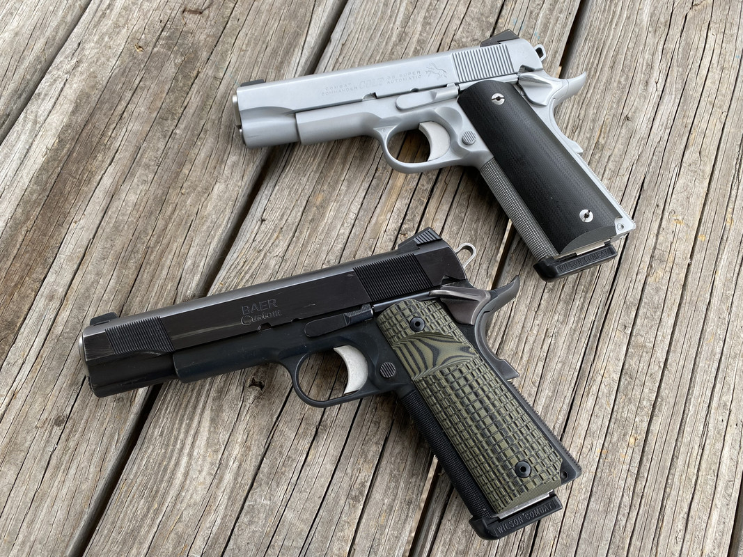

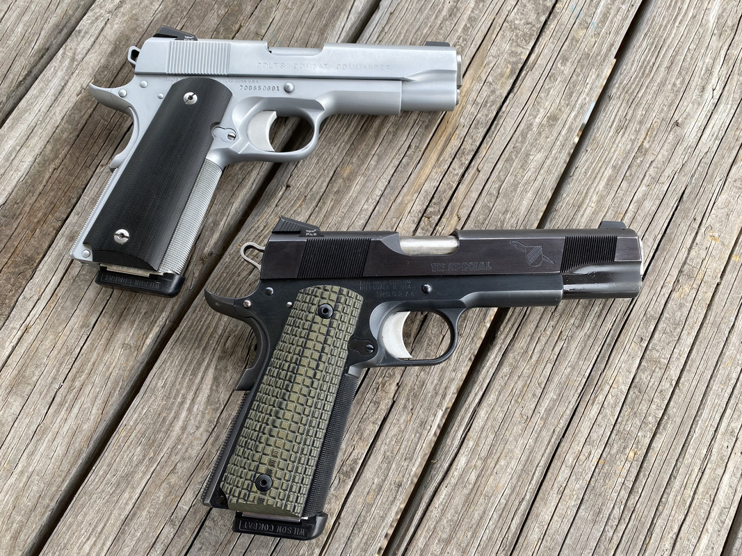

Get the 38 Super barrel and have it fitted to your gun. Now you have two calibers for the same gun. Here is my all S/S Colt .38 Super. Big Grin
