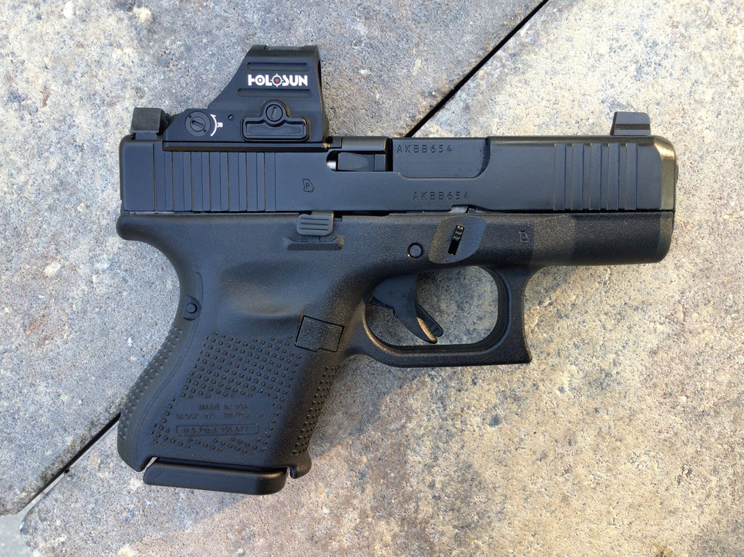

Hello guys. I purchased a brand new Glock 26 Gen 5 MOS, cleaned and lubed the gun, added a Holosun 407 and Ameriglo sights and took it to the range today to run it.
Well, things did not go so well. I tried several different brands of ammo and the gun jammed 15-20 times. I have never had this happen with a new Glock and I have owned around 30 of them over the years. I’m thinking the springs may just need to be broken in so I will leave it locked back for a week or so and try it again.
This is why you test your gun before you carry it no matter the brand.
Ammo used was:
Federal HST 124
PMC 115 FMJ
Zero 125gr HP
The gun in question.

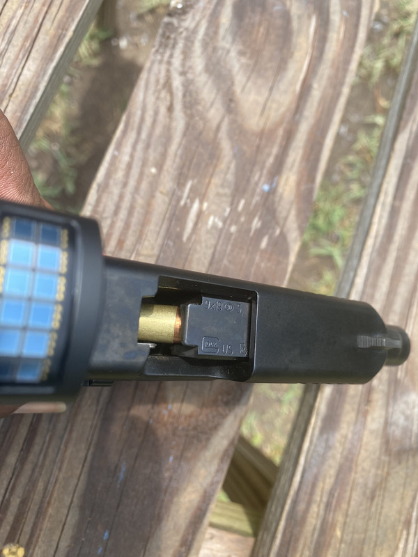

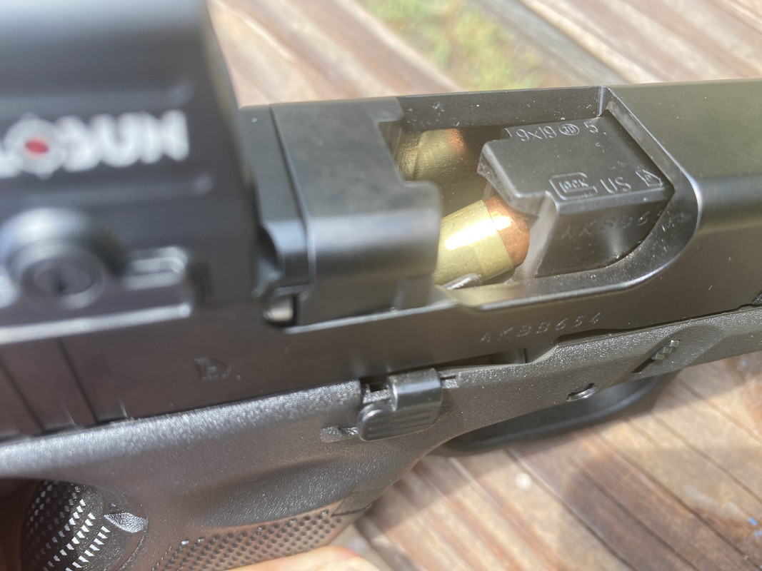

This is what was happening.

I have minimal experience even being around Glocks, but a complaint I first heard years ago was their vulnerability to “limp wrist” failures. That means that not only a firm grip is important, but as with other autoloading pistols, adequate slide speed is necessary for proper functioning. Adding the weight of a big optical sight to the slide obviously slows its movement, all else being the same.
All that being true, though, the problems you pictured are failures to chamber and I would expect those to be due to issues other than slide speed, such as an out-of-spec barrel.

Hard to tell from a pic but the feed angle looks odd. I would try a different mag or mags.

Problems due to low-powered ammunition, including lightweight bullets; excessively powerful recoil springs; inadequate lubrication and/or cleaning; and the infamous “limp wrist” almost always show up as failures to extract (i.e., pull the fired cartridge case out of the chamber) or failures to eject (i.e., throw the fired cartridge case out of the way of the next cartridge in the magazine). That is not what is pictured. Those stoppages are occurring after the fired cases are long gone.
If anything, once the autoloading firing cycle gets to the point of chambering a round, a more powerful recoil spring will actually tend to better overcome any hangup caused by a poorly manufactured barrel “feed” ramp.
Another thing that can cause a failure to chamber as pictured above is a problem with the cartridge case rim not slipping up and behind the extractor hook. But although I can’t be certain from the pictures, it looks as though the cartridge gets stopped before the case contacts the extractor.
Regardless of all that, and especially as your other similar models function properly, this should be an issue for Glock to correct.

Check to see that the screws used to mount the optic plate are not interfering with the extractor plunger assembly. If the screws used to mount the plate are to long they can make contact with the extractor plunger. This can mess up the cycling of the gun. I had the same issue in a Glock 45. As soon as I replaced the screw with a shorter one the problem went away.
August 03, 2024, 08:32 AM
sw4566
The Holosun supplied screws are too long. The mounting hole on the right side of the slide is drilled through to the EDP channel. The tip of the screw is touching the EDP and causing issues with the extractor. Remove the screw and file/stone it about. 2-2 1/2 threads. Or contact Holosun and have them send you the correct screws. There is nothing wrong with the pistol.
