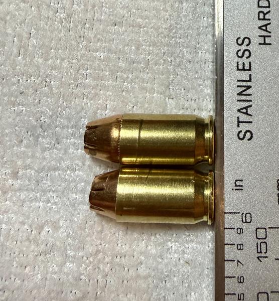

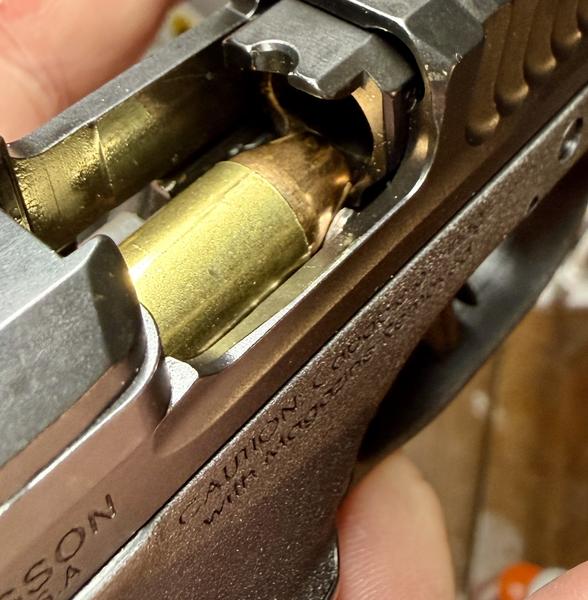

Picked up some Federal Punch 85gr yesterday. Just tried to hand-cycle some through it, not going to waste time heading to the range otherwise. No dice. It won't even chamber them 50% of the time. Hanging between the feed ramps. And creating setback in the rounds too - I measured one at nearly 2mm of setback after attempting to chamber it.
Will be in touch with S&W shortly.

For anyone following the saga of my S&W QC issue, I sent the pistol back for warranty eval and they received it around 9/24. They were reasonably quick on the turnaround - I got it back in 3 weeks. Ramp and barrel polished. Range test yesterday was flawless with 75 rounds of FMJ, and better yet, flawless with all three of the JHP rounds it wouldn't eat before. Shot about 25 rounds each of Sig Elite Defense, Hornady Critical Defense FTX, and Federal Punch. Will probably need two or three more good range days before I'd consider regular carry, but looks to be much improved.
Posts: 993 | Location: Virginia | Registered: May 16, 2007Reply With QuoteReport This Post

Besides the ramp, where on the barrel was polished?
Posts: 3577 | Location: Southwest Indiana | Registered: December 12, 2004Reply With QuoteReport This Post
The air above the din
Picture of Aquilon
It was just the ramps. The note they sent back with the pistol said polished barrel/chamber.
