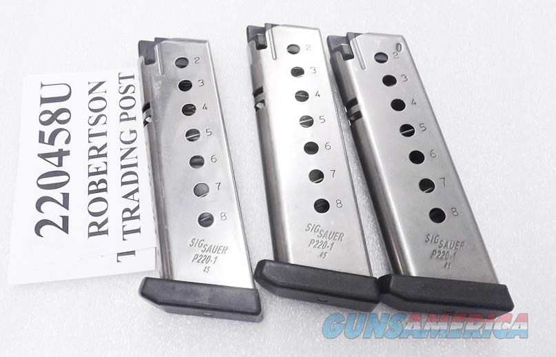

The most current 8 round mags are the most reliable, next would be the older 7 rnd mags, then the not as recent 8 round mags. I believe, according to my Masad Ayoob Sig Sauer book, the only P220 mags that caused any problems at all were some of the very early 8 round mags.
Random interweb picture, most current P220 8 rnd mag is the one on the right, with the little pressed in notch on the side, upper, rear by the "2". The other 2 mags in this picture do not have the notch but are fairly recent production I believe.
