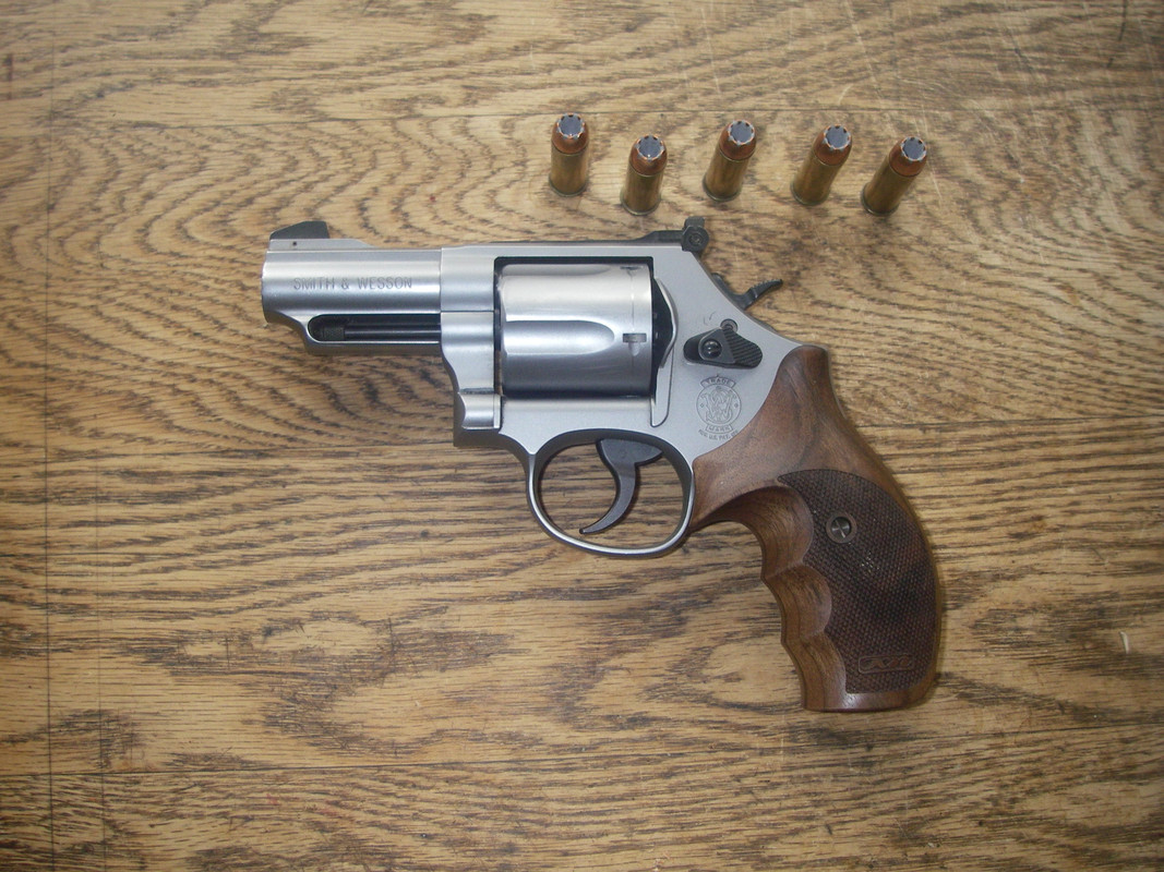

The Model 69 does not have a detent on the end of the ejector rod and nothing to jamb if the rod is screwed out some. I have the 2 3/4 inch and the placement of the cylinder latch detent is even different between that and the 4 1/4 inch model.
https://i.postimg.cc/28SFjHdG/...h-Nill-grips-006.jpg
