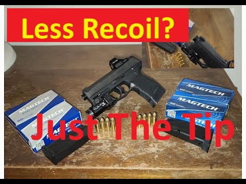

Just got my hands on the Aim Surplus “Just The Tip” (JTT) barrel for the Sig P365.
TLDR for those that would rather read about it than watch the video:
The Aim Surplus Just the Tip barrel is a drop-in 416R stainless unit with an internal compensator design, priced around $59–$69 (as of this video). I have 4 of these now (G43, G19, G34, P365) and none needed to be modified to fit.
Took it to the range recently and ran it side-by-side with a stock barrel.
Zero malfunctions and the difference in muzzle rise was noticeable, enough that I could easily keep the dot in the window instead of losing it between shots. I can do this with the factory barrel as well, but have to grip the firearm very firmly.
Follow-up shots were quicker, especially with the extended mags that give more grip surface.
For the money, this might be the best budget option for recoil mitigation on the P365 (and other) platform.
Definitely a solid value compared to more expensive threaded barrels/micro comp, comps like the Ramjet and others etc.
If I can get my hands on the integrated comp slide from the larger P365's I'd love to compare!
What’s everyone’s experience with these internal comp barrels?
