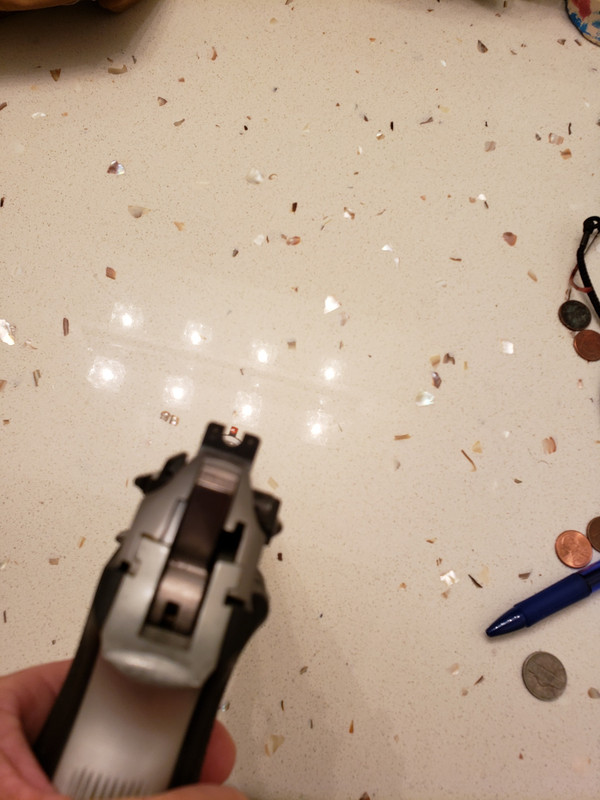

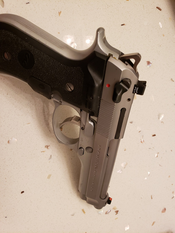

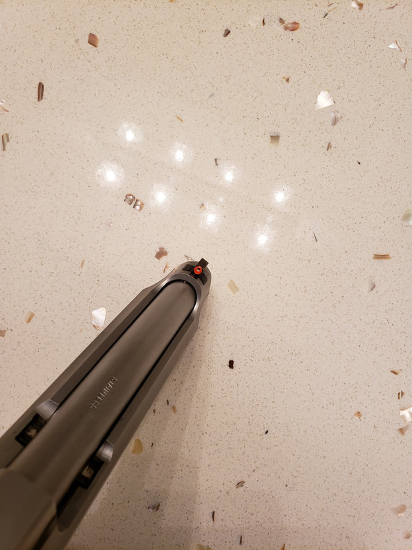

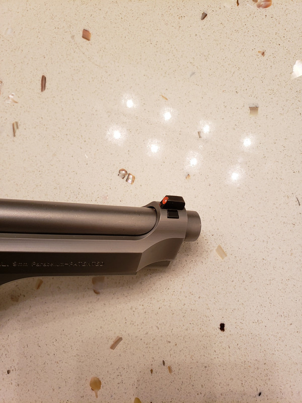

Unfortunately, i am presemntly incapable of posting pictures but if someone want some via email to post, I'm in.

Picture of JAFO
Feel free to email them to me and I'll post them. Email is in my profile.
"I drank what?" - Socrates
Posts: 5182 | Location: S.A., TX | Registered: July 20, 2006Reply With QuoteReport This Post
Picture of JAFO
Posting for car541:
