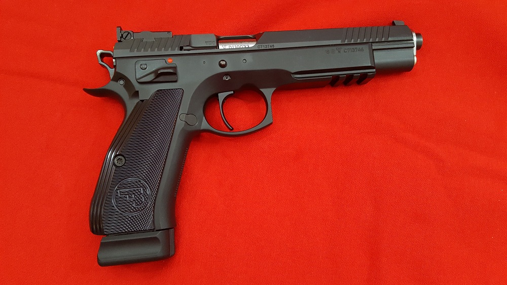

So, how does this fare actually in hands? The frame is from the SP-01 Shadow fitted with a SAO trigger mechanism. The thin aluminum grips makes the gun feel too thin, especially with the reduced reach of the SAO trigger. Already ordered the palm swell grips from LOK. How is the trigger pull on this gun? Although Frankonia says the weight is 1.25 kg (2.8 lbs), my Lyman digital trigger scale measured it at 2 lbs 1 oz (average of 5 pulls). Yes, fantastic light pull. What about the trigger break from the sear? No "glass rod" break, because you can definitely feel a slight slip before the sear let off. This is consistent with what all4shooters reported. This is what I find interesting. I've owned several CZs previously, from stock to CZ Custom to CGW Pro package, and they all exhibit this characteristic let off. On stock guns, you feel the actual grittiness between the sear and the trigger notch. On the trigger worked over guns, the grittiness is mostly gone, but the slip, although smooth, can still be felt.
Test target shows the error the Frankonia shooter made when writing down the serial number (supposed to be 46, not 66). Finish is typical black of the CZ pistols. Frame to slide fit is tight.
Barrel bushing and recoil spring plug. The cut out on the left side of the bushing is to allow the plug to pass forward during field stripping.
Correct serial number (46), not 66 as written on test target. The mangled looking symbol is actually the ID mark of the Czech National Arms and Ammunition Proofing Authority in Prague. It's a 2-tailed lion walking on its hind legs, inside a shield. A clearer marking is shown on the barrel hood. CIP/N is the actual proof mark indicating the gun has passed the testing. About the 2 other markings right above the extractor, the checkered shield appears to be the mark of the German Mellrichstadt Proof House and the CA inside the shield is probably the 2-letter date code (CA = '20). Notice the barrel's serial number is different from the matching numbers on the frame and slide. Vendor (MMBI) checked with their German partners, and it was confirmed that all their Taipans are built this way.
Front sight is pinned from top. LPA rear sight is fully click adjustable for windage and elevation.
Inside frame shows uneven finish typical of the CZ pistols.
The barrel hood and locking lugs, and the inner surface of the forward area of the slide, are brightly polished.
Recoil spring, plug, guide rod, barrel bushing assembly, full-size 1911 style
Size comparison with the Shadow 2 Orange
The 6-inch Taipan is a full 2 oz lighter than the 5-inch Shadow 2 Orange (44.6 oz vs 46.6 oz). Interesting.
