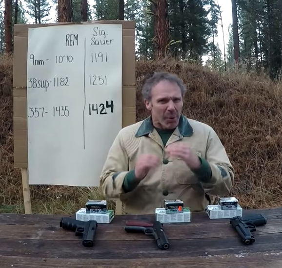

Wish Paul Harrell would use something a little less complicated to shoot than his mix of rack of ribs bag of oranges and layers of tee shirts... just a little too silly for me. Hell I'd just use a good size pumpkin.
But here is his real results from his comparison:

Paul Harrel is great! Very informative videos. My only complaint is he used factory 38 Super vs Factory 357 SIG.
There's no comparison there. Most Factory 38 Super is downloaded to much lower velocities (sometimes 9mm is faster). In that context, 357 SIG is superior.
The 38 Super is a reloader's cartridge & being so it can attain it's true potential & run virtually neck & neck with the 357 SIG. With the scarcity & price of 357 SIG, the 38 Super is relatively cheaper & more available but is limited in the type of pistols that shoot it.
As for the "meat target", I like it. It is a good representation of what bullets do when impacting meat & bone. Far better than ballistic gel.

I think that is a common misconception that is often restated on the internet. Some years ago I posted on the ammo sections of the Sig forum and S&W forums my actual chrono test results from factory 38 Super. If you do your own testing, I think your opinion will change. Keep in mind that not all factory Super ammo is +P, such as Fiocchi and Armscor.
My tests were done with a 5" Colt and a 4" Sig. Winchester 125g Silver Tip averaged over 1200 fps even in the shorter P220.
Exactly my point. 38 Super should run in the 1300 fps+ velocities. 1200 fps can be equaled by 9mm fairly easily.
Agreed on your testing. I also used a 5" Colt Competition Series for my testing. Fiocchi, Armscorp, PPU. None exceeded 1300 fps W/LAB radar unit.
IMO, factory 38 Super ammo is downloaded to this day as a safety margin because those old 38 ACP's still exist.
To get the full potential, one needs to reload or purchase Buffalo Bore type loadings.
