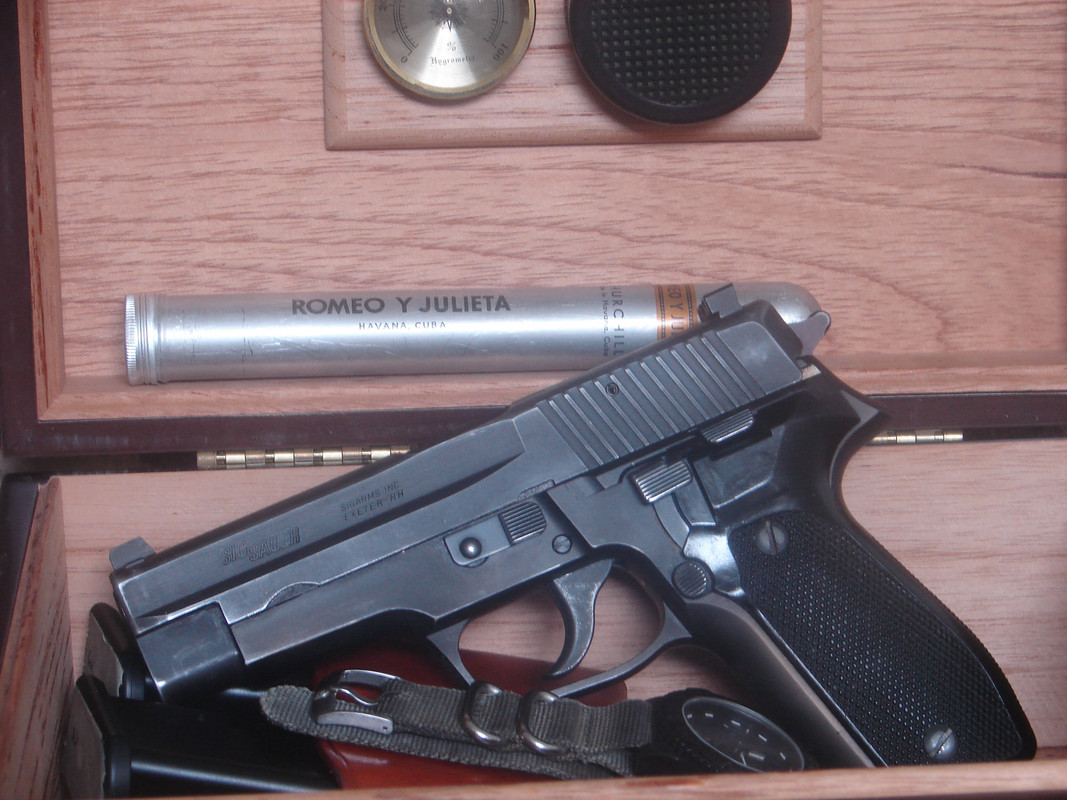

Apologies for the delay in replying. I had some pics from a few years back, but they are on an old hard drive that I'm not able to access right now, so I had to make the time to take a few new pics.
I think you are going to be disappointed, as we're not talking about some collection-grade museum piece. It has its share of dings and missing finish...in fact, in the right light, you can see the anodized finish starting to wear on the frame grip to the point where it is starting to turn bronze/ gold like (similar to the Flork frame rail description)...but, as I'm starting to become a bit long in the tooth, I tend to have an affinity for a few possessions that have accompanied me on the journey, and this particular P226 is one of them. Wink
It's not my oldest P226, but as both my first handgun and the one that I carried the most/longest, it's the one I have the strongest attachment to.
Please excuse the dirty gun and the rushed pic quality.

Picture of elberettas
I am not disappointed one bit! Beautiful pics of a beautiful piece. Thanks for taking the time!
