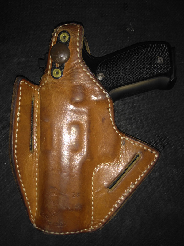

As I mentioned in another thread, I’ve had it happen a couple of times. It was long ago when I started carrying a P229 in a Galco “Concealable” holster and after switching the magazine catch to the right side of the gun. After realizing it wasn’t due to my failure to seat the mag in the first place, I decided the problem was due to the fact that the leather of the holster covered the mag catch and any pressure on the holster in that area would release the magazine.
The picture shows the notch I cut in the holster to relieve its pressure on the magazine catch. Even though my alteration wasn’t perfect, it was sufficient to prevent the problem from ever recurring.
This is a spare holster of a slightly different design, but same model, that I purchased a few years after the first one. The leather partially covers the mag catch, but although I’ve never carried in it, it seems to require much more pressure on the lever to depress the catch than the older one did. If I ever switch holsters, though, I’ll probably punch a notch in the new one for the same purpose. (Evidently because the holster has never been used, the pistol doesn’t seat as far in either.)
