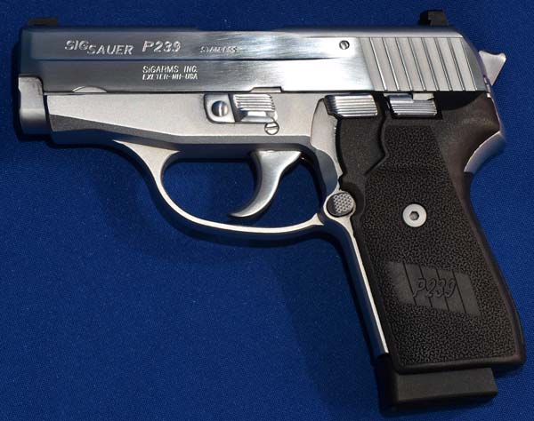

I inadvertently bought a P239 on GB. I have one already but that's another story.
I'd like to make the slide look stainless or maybe dark grey.
Any suggestions? Which Cerekote number/finish.
Chris

Since the slide *is* stainless, why not have it bead blasted for the natural look?

I agree, if the slide is stainless then have them bead blast it.... then if the lower is black have them put the coating on that. I have one like this... that I carry but the coating on the lower is starting to rub off.

Thanks for the inputs. I've used CCR in the past. Got good results and fair pricing. Bead blasting sounds like it might be better. I'll have to think on it.

I've bead blasted various stainless pistols and slides, to include a couple of SIG stainless slides. Where possible, I much prefer a natural stainless finish with nothing to wear off, over most plated or sprayed-on finishes. One exception I might make, is for hard chrome. HC, is simply the hardest, most durable finish I've ever had on a pistol. FWIW, for a fine finish with a slight sheen, the Brownell's 270+ glass beads do a beautiful job. For a much grayer/darker finish, I've used aluminum oxide. A commercial refinishing outfit should be able to duplicate this with whatever blast media they prefer in the different grades.

I'm in the bead blast camp. I have a P239, P226 and P229 that were done by Sig.
EDITED: Forgot to mention that I also have two P320 slides I sent to Sig for bead blasting. P320 Compact and Full Size.
Bead blasting looks better in person than in photos. It actually has very, very light gray appearance rather than a shiny silver look. No glare in sunlight either.
Reasonably priced and durable. I would prefer a natural finish rather than an additive type.

Lots of great comments, thank you. I received the pistol an hour ago and there isn't a mark on it. I mean just like new! It's been fired by a look down the barrel, but otherwise it's look straight from the factory.
I think I'm going to leave this one alone and re-look the older one in my safe for a slide redo.
