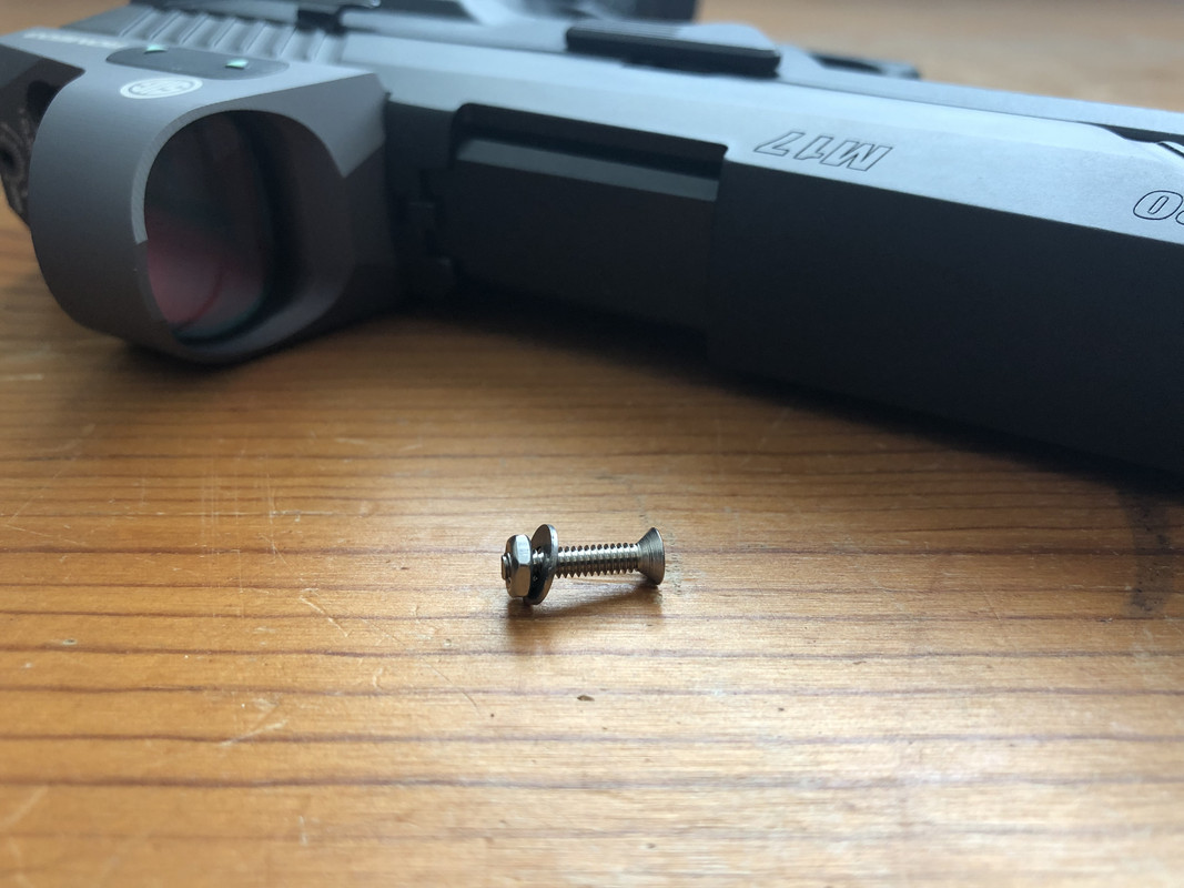

As a homage to the Max Michel X5 Romeo3Max, and a little “can it be done” craftsmanship... (and out of a little jealousy) I created the M17R3!!!
Using a M17 slide, I was able to mount a Romeo3 directly to the slide by removing rear notch material from the slide. I couldn’t find a shop that would take such a small project, so I had to do it myself. A belt sander got me started and I finished it up with a file. Once the mounting area was flat, the romeo3 almost lined up with the screw holes that hold the rear sight in place, but not quite. There was enough space to get some smaller screws through the slide and optic allowing for a secure mount. Unfortunately, I didn’t think to take any pictures during the filing process or before tightening everything up... and it’s already zeroed in... so, sorry!
So far it has held up for about 100 rounds.
Thought I’d share it...
