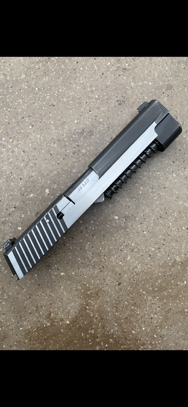

I did much the same thing with a P226 to make a Fauxquinox because I liked the look. Mine was black Nitron which came off easily with varying grits of sandpaper and polished to a nice gloss. I suspect the matte stainless on your slide will take a LOT of elbow grease to put a shine on with Mothers if you're not sanding as well, and you may need to consider using at least very fine grit paper to speed the process. I imagine the slide serrations will be largely unaffected.

Yes it will work. I'd prefer to use Collinite metal wax for polishing. I would tape the top that you don't want to shine up with good tape so you have a nice clean line, perhaps electricians tape. If it's a bead blast finish it's going to take more effort, and probably will need a small buffing wheel on a drill or Dremel and jewelers rouge, or the other option is to wet sand it, start with like 400 then 1200 then 3000 grit then buff it.
