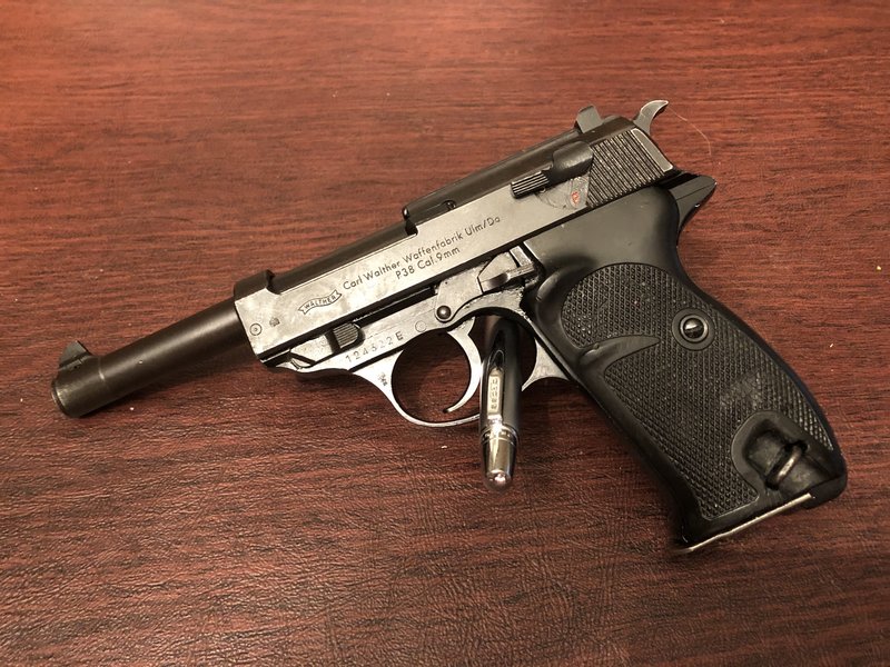

Yeah, early 1960s. Is there a date on the left side of the slide?
The "E" prefix s something of a mystery, even for the experts. No one knows for sure what the E means. One thing I can tell you for sure is that it was not part of the original serial number. These "E" marks are all applied by hand after the fact.
Some say it's for "Export" but I think that's wrong. Yours looks for all the world like an ex-military piece. Any markings on the magazine?

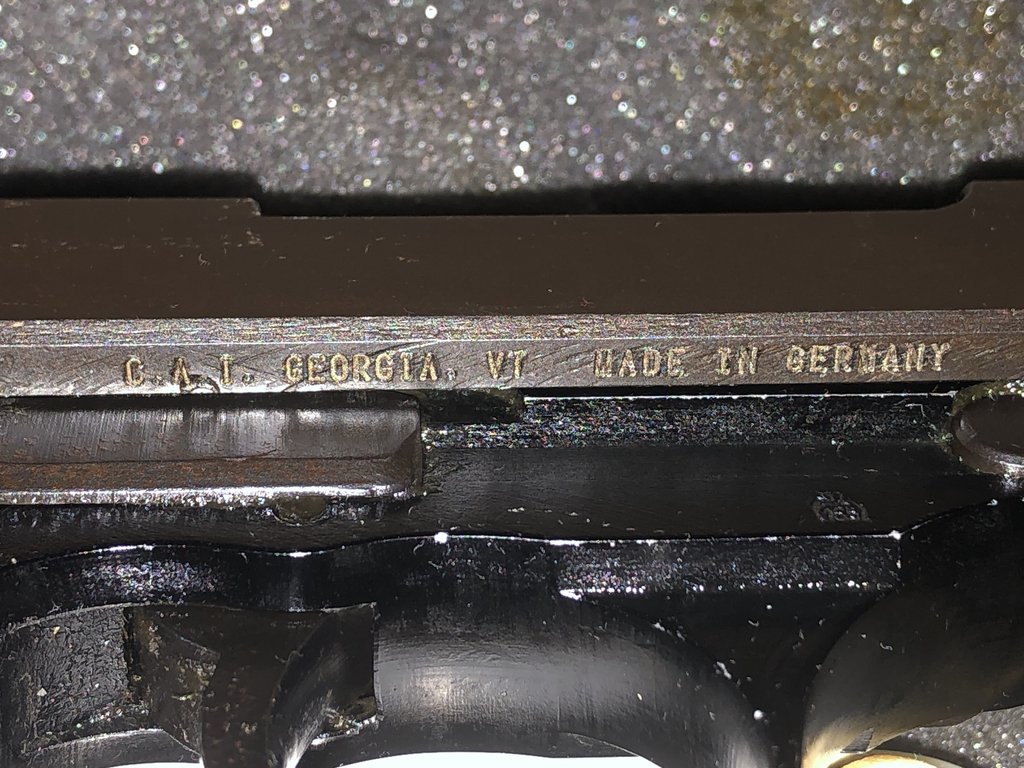

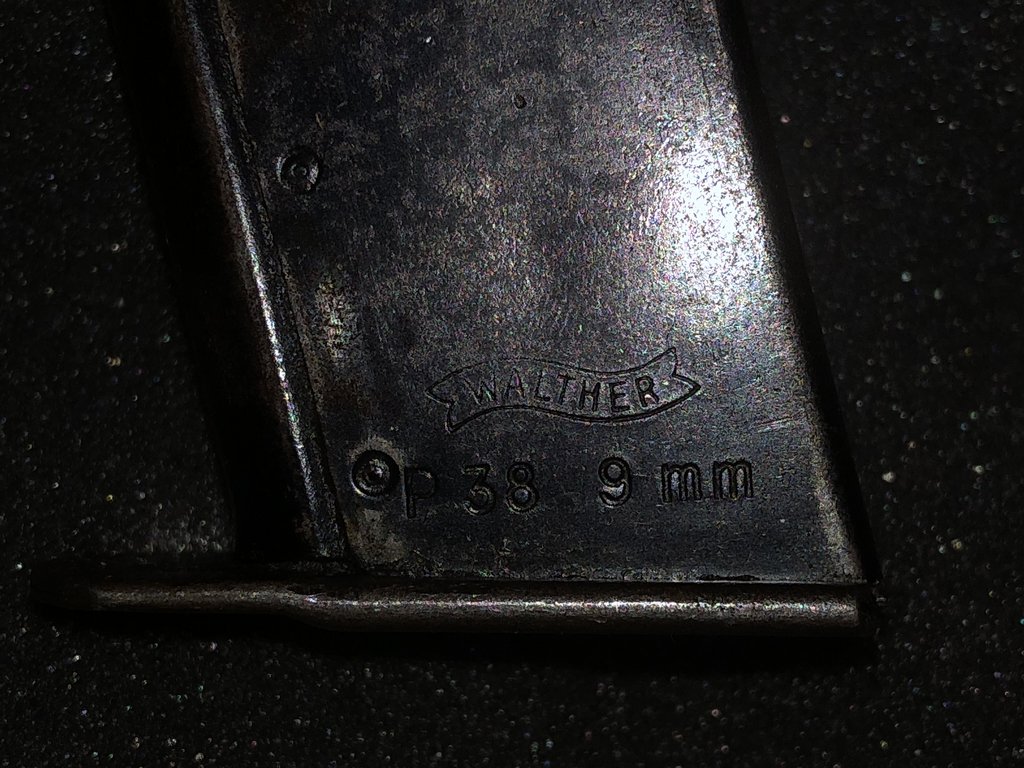

First look over I didn’t see any right side markings, but a little wipe and 2/61 became visible. Mag says “P38 9mm”. Finish doesn’t really match the pistol, so I don’t know if it’s matching to pistol. Also found the import marks, had overlooked them first glance too.

The mag strikes me a bit odd. The base plate shifts a bit, front to back. And taking it apart, the detent plate seems oddly shaped.
They all move a "bit," but maybe yours is loose. The 'detent plate' I think you describe should be bent up at the front and have a notch at the rear for the dent at the rear of the base plate.
