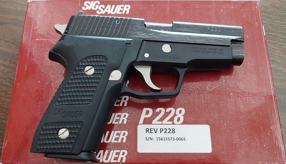

Originally posted by dubagel:
I’m confused. I’ve never seen a P229 slide that’s marked P228? Was that some sort of prototype slide?
The stainless slide P228's history is detailed >>here<<.
