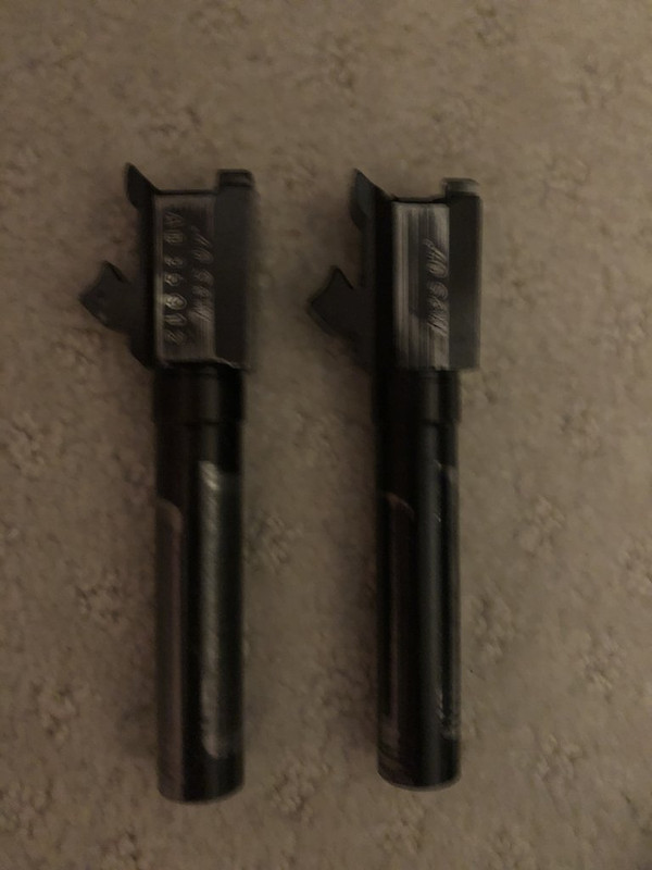

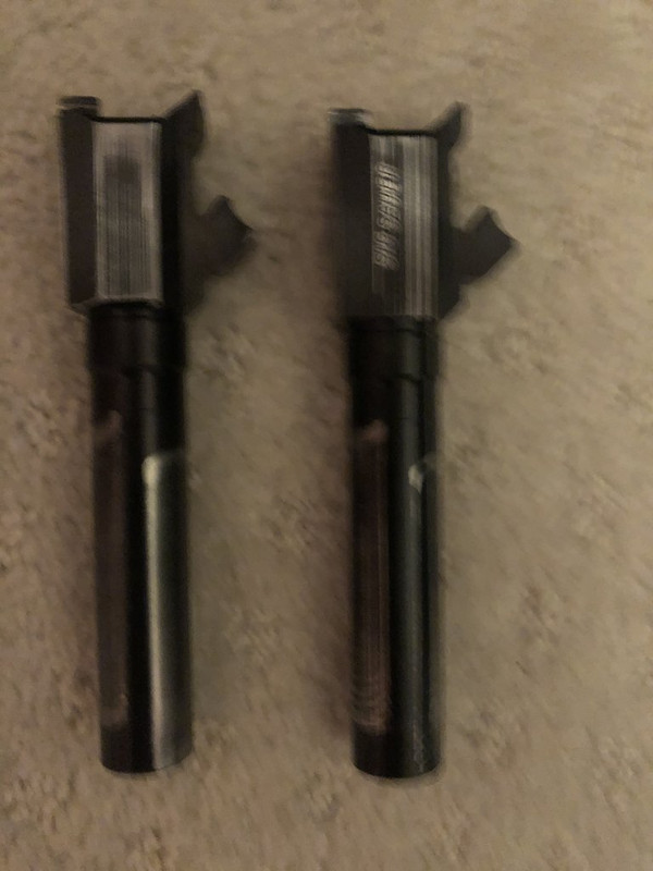

I’ve got two P229s. One I’ve put thousands and thousands of rounds through. It was my EDC, 3-gun competition pistol; my go-to. It’s always rattled and been loose. The other was my dads. He gave it to me when he knew he was never gonna shoot it again, but he never did to begin with. Has probably had no more than 300 rounds through it. Real tight gun.
Here’s their barrels (loose on left, tight on right):
The breech area is where the lockup occurs (well, and the locking block). The well used, loose one has less wear on the breech.

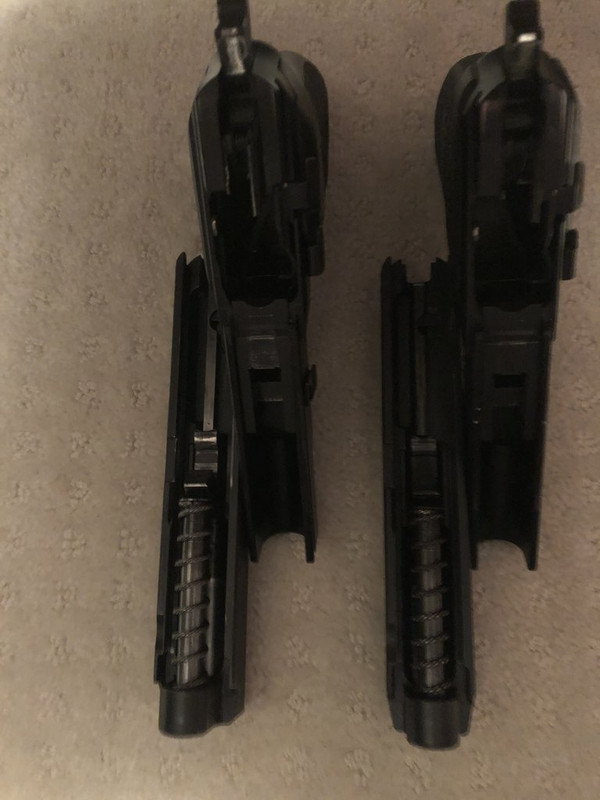

Then if we look at the frames:
You can see the loose, well-used one actually shows little to no frame wear while the tight one shows some finish wear on the back of the frame rails after just a couple hundred rounds. The barrel and guide rod are almost polished from wear, so you can see its been shot quite a bit. The other has more wear on the breech, but barely any on the barrel and guide rod.
They both shoot like lasers. So put your mind at ease, you’re not going to wear your pistol out. If you were to, you’d have spent 2-3x (probably more) the cost of the pistol in ammo. Enjoy the pistol, lube it right, and don’t worry about it. It’ll still be great when you’re ready to pass it down to your kids.
Yeah, the pictures are bad, even for me, but I’m not gonna take them back out to retake.
Had to do a bunch of edits to clean up my post but one last one: none of the above wear is any problem or cause for concern. All perfectly normal.
