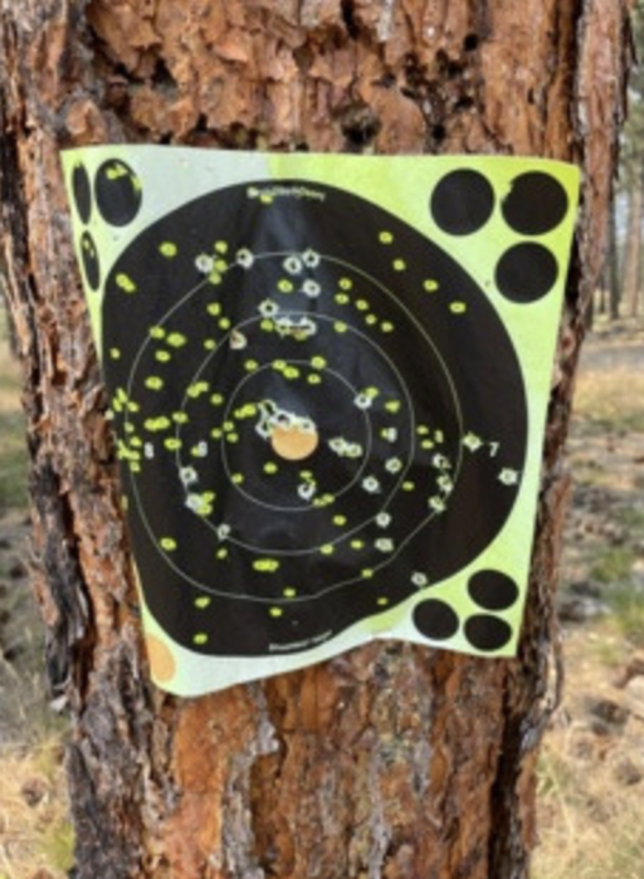

I load 160gr of 9-shot in 45 Colt. Pretty effective at 15'.

Half again the payload weight of #9 in .44SPL and a really nice pattern, Gustofer.
How do you construct the loading, components, I mean?
Gustofer, that is definitely impressive. I'm also curious how you put your loads together, and what gun/barrel-length you're shooting them out of.
I have some .45 Colt shot shells that a buddy made using a couple of gas checks to sandwich the shot. They work decently well, but the only platform I have for launching it is a 4 5/8" Blackhawk, and while I have carried it in the woods I've got better options these days. I'm still always watching for a decently priced, short-barreled .45 Colt double-action revolver.

7.5gr of Unique, thin cardboard (cut with a sharpened case and tamped down with a dowel), shot, then a 45 cal gas check. As I mentioned in that thread, the gas checks are kind of a pain to get and keep seated right, but the 44 cal ones were too small. So, I just made a little bigger bell and they work great. Haven't had the opportunity to get a snake with them yet, but I've taken a number of squirrels and chipmunks who got a bit too brave. I have a 4 3/4" SAA.
This is the only caliber I've loaded them in as I've got a bunch of CCI ones in 44 and 45ACP. I was just never able to find any in 45 Colt.
