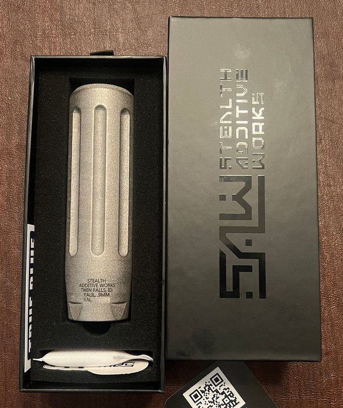

Back in April, I went to the East Valley Tactical Suppressed Range Day at Ben Avery in Phoenix with the guys. Lots of vendors and manufacturers, a lot of the big name brands were there. You know them. Recap thread here. I shot a lot of cans that day, nothing impressed me the way the Stealth Additive stuff did. I know, sounds super shill, I'm just being honest.
I emailed them a few weeks later asking if they had any plans to do a 9mm can, because while rifle cans and .22 cans are great, what I've been shooting the most of is 9mm through PCC's. It's quiet, it's cheap, it's a reasonably close analog to a suppressed rifle for training purposes, and under NODs, it's an absolute giggle. We traded emails and then texts over the next few months, and then to my surprise, I got an email for an invoice. With Matt Liebe of Stealth Additive's blessing, I can tell you the following:

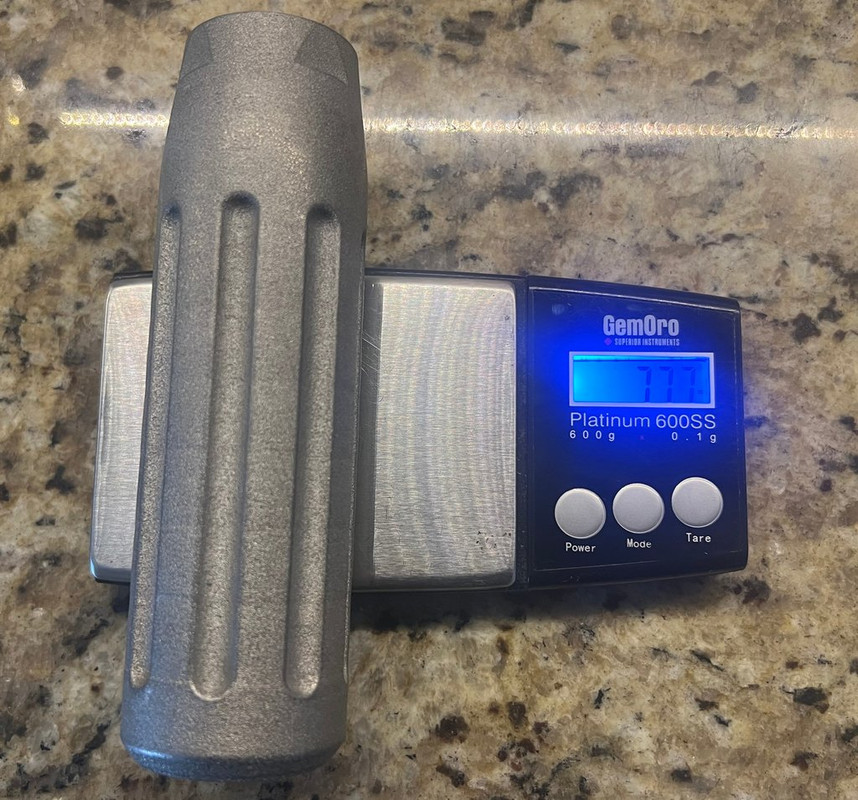

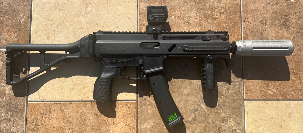

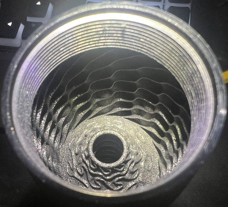

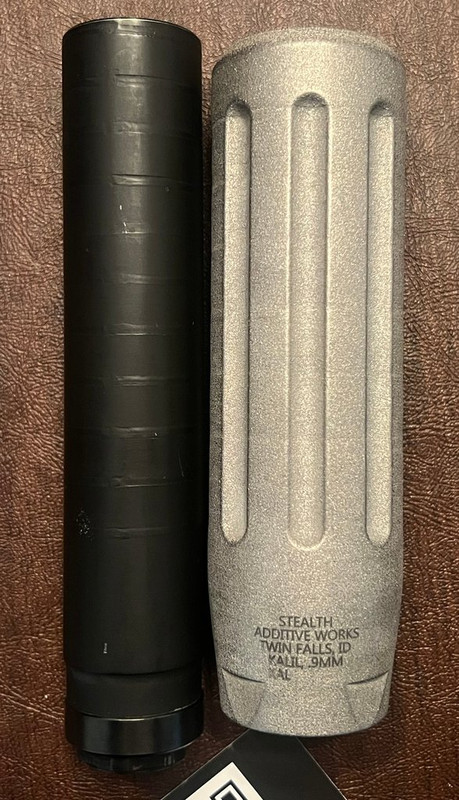

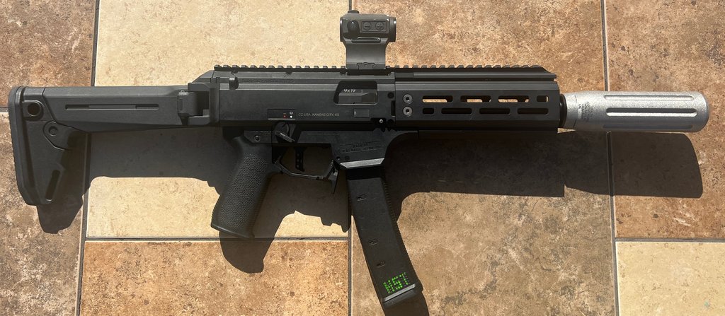

The Kalil is the evolutionary dead end that led them to a can they'll be bringing to market soon called the Shiloh. They look pretty similar, but they made some rather notable improvements on what I have here, which is one of two Kalils produced. It is 5.9" long, 1.77" in diameter, weighs 7.77oz. Mount is the Resilient Gen 2 titanium tri lug because anything else felt like a disservice. With mount, it's 10.2oz. Pictured below with my Ecco Machine Phoenix TL (ten baffle version, 6.5"), along with a few hosts. Haven't shot it on the Inox yet because... I don't yet own a piston. I know, kind of silly, but all things in time. I opted to have them leave it unfinished, raw titanium for grins. It's a girthy can, and the tone is great. Matt says it's rifle rated to .308 and no barrel length restrictions, but I'm probably only ever going to use it as a pistol can.
After a several range trips, a PCC match and a little over 500 rounds through it with a mix of 115gr, 124gr, and 147gr subs, I can say it's very quiet, and there's little to no backpressure as far as I can tell. A/Bing it on the Scorpion vs the Ecco was pretty dramatic, you can feel the difference. I really should have cleaned the Stribog first, because it's really hard to tell how much of the fouling that's in it was already in it vs what the Kalil blew back into the action. It doesn't seem any dirtier than it was before I started testing it. The Ecco Machine Phoenix is a great can, and hot-swapped out with a YHM R9 and a Rugged Obsidian at a prior range trip, everyone around concluded that the Phoenix is quieter. To both the shooter and standing several feet to the right of the shooter, the Kalil was noticeably quieter than the Phoenix. On my Stribog, and my friend's AP5, the Kalil was what I would call hearing safe. It's the first can I've tried on the Stribog that didn't hurt my ears without ear pro. No random ringing afterwards, either. We also compared it to his new Flow 9K, and it was quieter than the Hux. I could hear the difference in backpressure between the Kalil and the Ecco when he swapped, it was a bassy thump out of the ejection port with the Phoenix. I don't know how surprising this is to anyone, but I was shocked that 124gr PMC Bronze was not only subsonic, but so quiet that the shot timer wouldn't pick it up unless the RO had it right up on the ejection port. I guess it'll be 115gr stuff for 2 gun matches with "Open PCC" as a choice.
Further testing and comparison will be done as soon as fire restrictions on BLM lands lift. If anyone cares, I can post footage of flash testing through NODs. Of the video I've gotten, a little bit of port flash from the first shot in a string is the first I've seen. No idea if it's a sparky boi, or if subsonic 9mm will even do that with titanium dust.
The can that Stealth Additive will be bringing to market, according to Matt, will have slightly more backpressure, but is even quieter than the Kalil. Based on the features and it being much lighter and even quieter, I'm kind of tempted to eventually pick one of those up as well. If what he told me is correct, it should be sub 3oz, which is insane. The Stubby they've recently brought to market is 2.4oz and can be used on a Glock without a booster and still cycle. SAW is doing some neat stuff.
They didn't give me this one for free (I paid approximately a Polonium for it) and they didn't ask for me to write a review or post on media. I asked if they minded my talking about it, and Matt said to go for it. I'm not bought and paid for, I'm not a GunTuber, I'm not a social media shill, I'm just a guy who got excited about some suppressors and asked for one in a caliber they weren't making yet, and they hooked me up before they were really ready to bring anything to market.
I have since sold the Scorpion to a friend, and I'm planning to pick up an Ekron 5.56 to live on my 11.5" URGI. There are other titanium cans that are a little cheaper and if I want to spend another $400ish on a Dillon, I can get shorter and quieter, but nobody currently has Stealth Additive beat on the backpressure from what I'm seeing. Nobody comes close. Several times, I've pulled half-empty mags just to look at the rounds on top and there's no fouling on them with this can. It's a massive difference between it and the Ecco. Really looking forward to doing more testing since most of the guys in my NV group have 9mm tri-lugged hosts and their own cans. If the weather keeps doing what it's been doing, I should have some interesting comparison footage through NODs pretty soon.

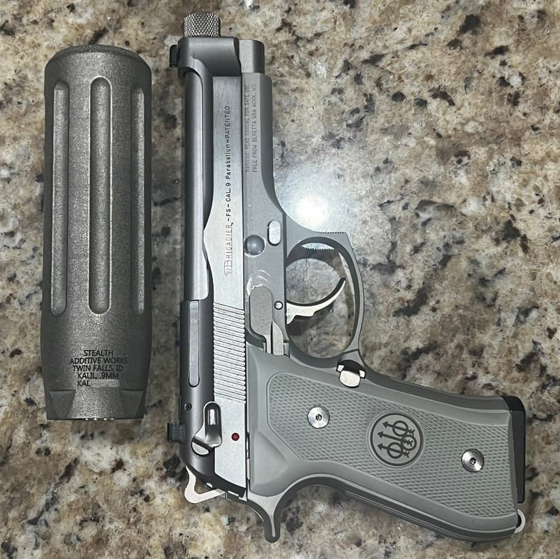

Oh, a friend of mine picked up a Hux Flow 9k. It comes with a Hub booster assembly and I believe a piston for 1/2x28. He asked if I wanted it. I may very well get it off him. I kind of want to see what this can would sound like on that Inox 92 Brigadier. Problem is, I'm pretty sure that threaded barrel is 5/8x24. Roll Eyes
