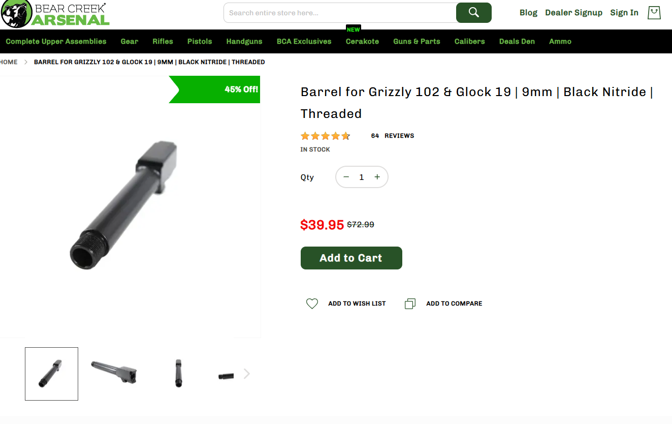

Easy. Get a G19 barrel first (and a G17 barrel while you're at it because why not).
https://www.bearcreekarsenal.c...itride-threaded.html
Glock says it won't fit, but I can tell you it does. I already had it for my others, and since you have a bunch of Glocks it'll fit, this is a good one to have anyway. I know, Bear Creek Arsenal is supposed to be shit, but I've put a couple thousand rounds through this one and it's been great. The finish isn't amazing, but I truly do not care. It can't be beat for the price. I bought a Ballistic Advantage G17 threaded barrel and could've bought one of these, a G17, and a G22 9mm conversion barrel for what I paid for the BA, which has a tight chamber and I've had to hammer open with stuck brass in the chamber three or four times now.

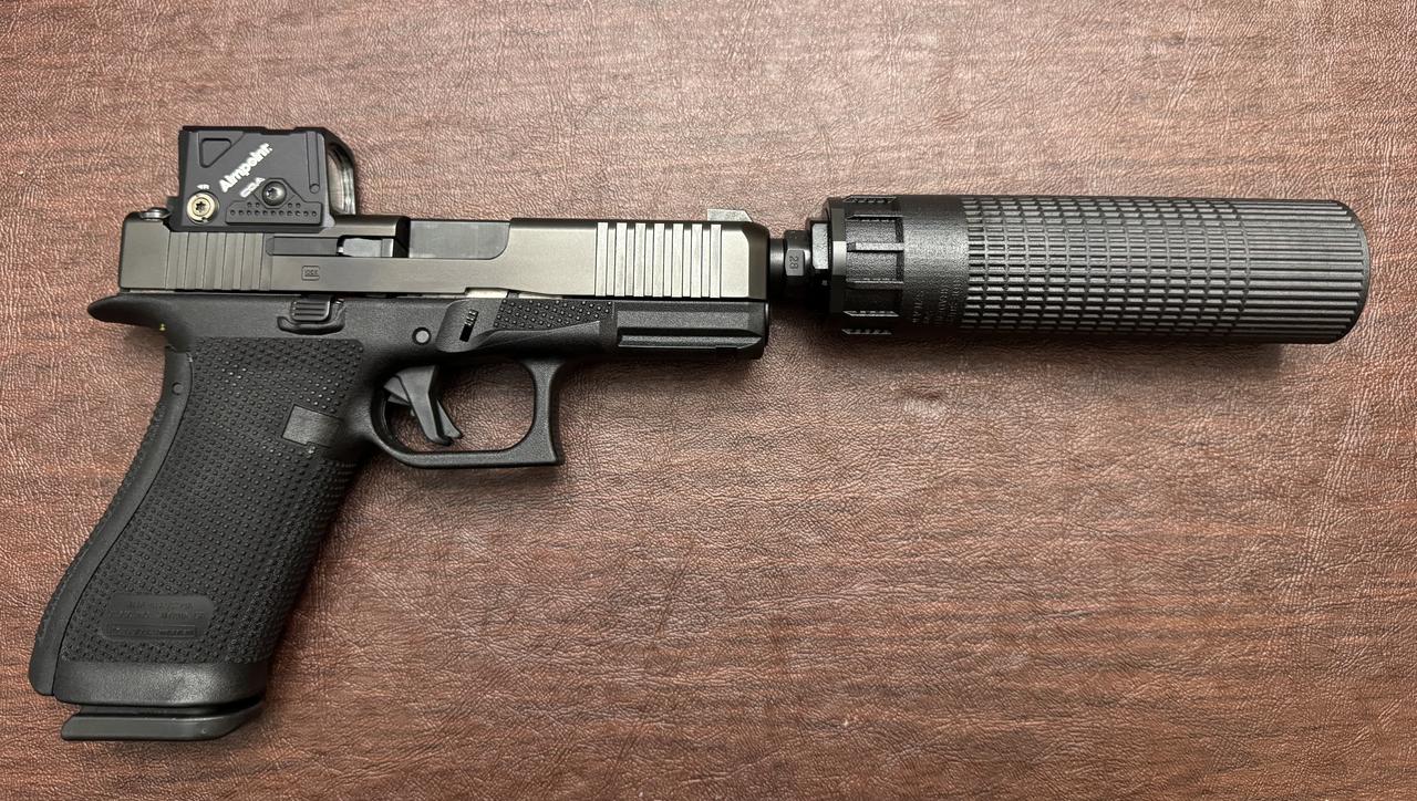

Proof it fits:

Thank you Sir.
I can certainly handle $40 for a threaded barrel. Eek
Already ordered it.
As well, thank you for the Sig advice; I'd be more inclined to get a barrel for the P226.
