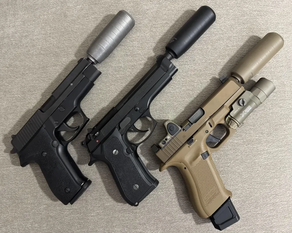

2) Low backpressure to the shooter's ear also tends to mean quieter to the shooter's ear. I own three Stealth Additive Works 9mm Shivs. It just kind of worked out that way with helping the company demo stuff, and I have a small selection now that live on my favorite pistol hosts. The short version is, they perform like a yesteryear full size can in terms of noise reduction and FRP, but at a fraction of the size and weight, and completely eliminating peppering to the face. Instead of feeling like a pistol wearing a heavy can, they change the balance point so little that it's usually the first thing people trying one out say: "It doesn't feel like there's a can on it." I've handed hundreds of people a host wearing a Shiv for the first time, and that was the experience that got me very interested. Trying them out on my pistols vs my cans and some friend's cans had me hooked. There are bigger pistol cans that are quieter to the bystander, but that's not why I use suppressors - I use them because I want it to be quieter for me. That's not even touching on the rifle cans for the sake of brevity, but it's the same experience there. Pic because, again, why not?

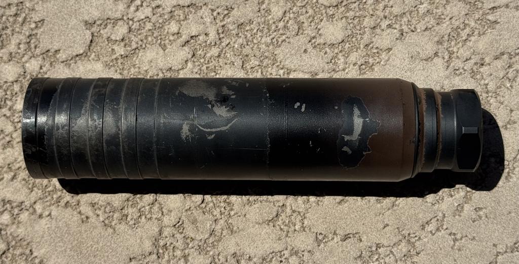

3) 3D printed titanium means ultra-light, but it also means cans that will start glowing in short order with higher pressure rounds like 5.56. I have a picture one of the guys took of me at a night shoot using my 5.56 Ekron as a lantern to light my face up from about a foot away after a 30rd mag dump at speed. It's also comparatively sparky even after it seasons-in, and will always be flashier than the same design in something like Haynes or Inconel. One of my suppressor nerd friends got ahold of one of the first Inconel 5.56 Tishas and it is super quiet and very low backpressure, but it feels heavy, especially compared to the titanium version. Upside: He can run FRT mag dumps through it basically forever without a care, that can in that material shrugs off the abuse like a masochist.

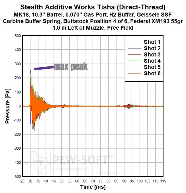

If 2023 was the beginning of the 3D print revolution then I think the SAW Tisha is the first 2nd generation 3D low back pressure can. CAT ST might fit in that 2nd gen category also.
There's some special magic going on with that 2 stage pressure relief in the Tisha. I do follow Pew Science, I don't hang on his every word, I go to in person demo days for real world experience. I do look at the measured data in PEW, and the Tisha is better at cutting down that nasty spike at 30ms better than any other 5.56 can.

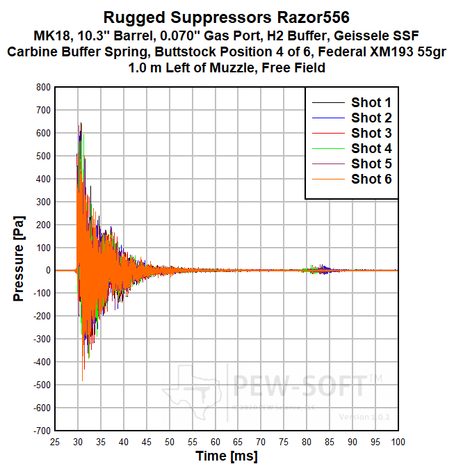

I'm showing a old school baffle can the Rugged Razor for comparison. You can see the spike is more than double the Tisha.
