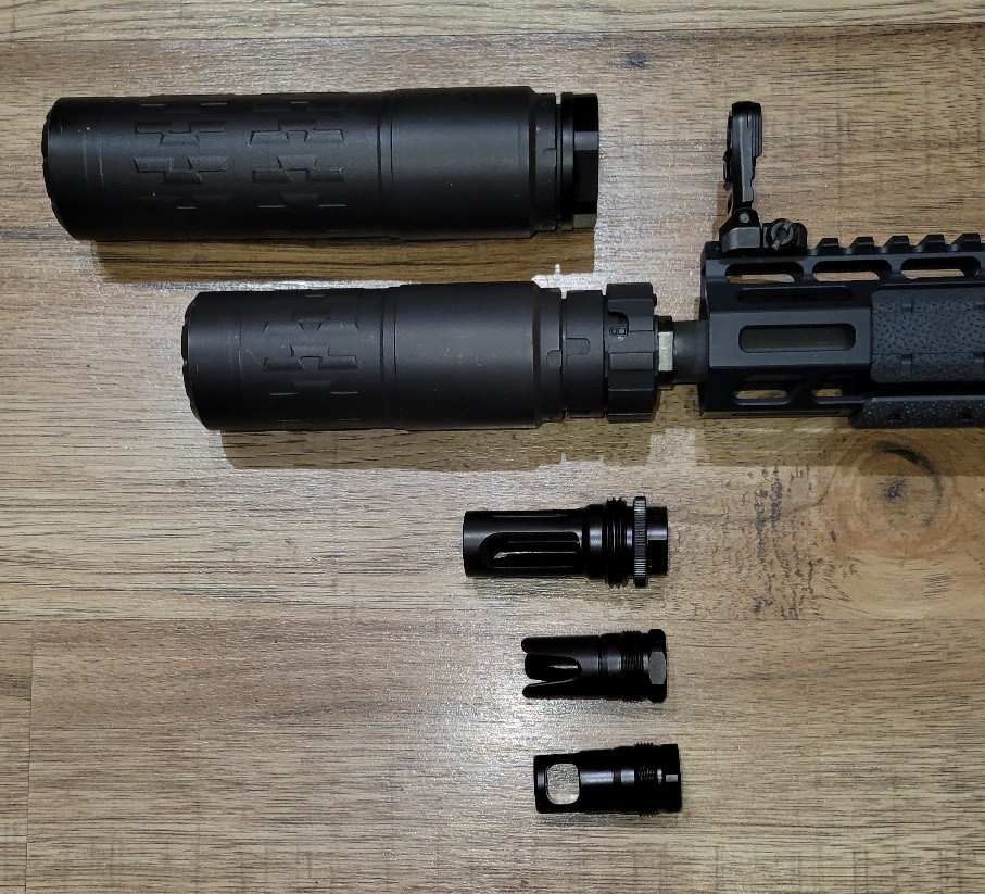

Top to bottom:
Velos 762 with Rearden Charlie Atlas mount
Velos 556k with SiCO ASR mount
SiCo ASR closed tine FH
Rearden FHD
Rearden SPB
I like ASR but I wanted to check out Plan B and see how much of a difference 4 oz at the end of the muzzle makes, and I can tell a difference. You can see that Plan B shortens things up on the mound the threads of the muzzle devices are farther back.
I also like the left hand threaded systems Xeno and CAT TSFX/Spooky. Spooky is an open source published design and Rearden has a Calico FH and has a mount coming out for it. Plan B is the leader right now, but I see benefits for LH threads and I think Spooky is going to gain market share.
In a separate category, as you have to setup the rifle for a reflex can, but I'm building a Gordy type rifle and thought the Otter Creek OCM6 sounded very good. This will be my next can when it comes out.
