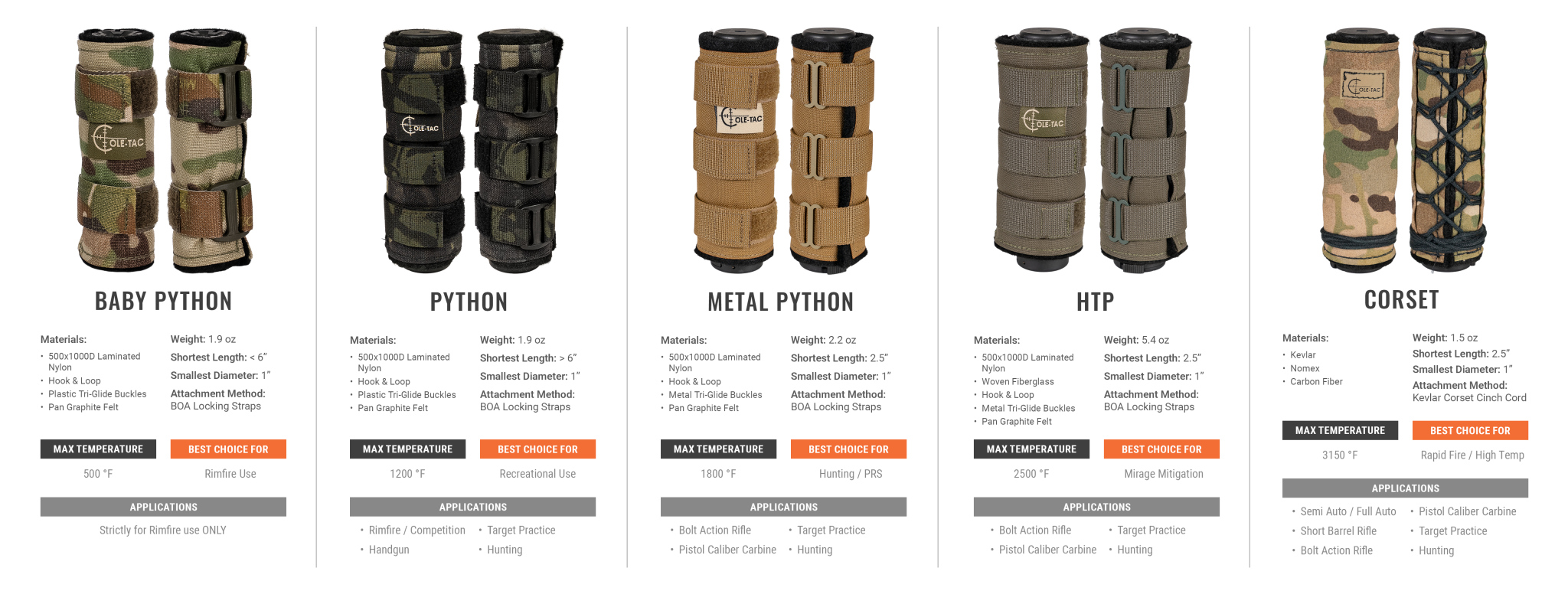

While I haven't used their suppressor covers, I've used a number of other Cole-Tac products, and they are good quality.
Looks like they have five different covers, for various uses/levels of heat protection:
Thanks. Even the AI Gemini recommended the Cole-Tac HTP although in that line the Corset has the highest temperature tolerance rating. But as I say, my question is how do they retain the heat to minimize “mirage” effects? Creedmoor Sports is the only vendor I’ve seen that claims a specific mirage reduction effect, but the description of the cover itself doesn’t make it seem any different in that regard than the Cole-Tac offerings.
I suppose the answer should be that if a cover can stand some X temperature that’s higher than another, it wouldn’t be very useful if it didn’t contain it to a reasonable degree as well. A stainless steel cover would stand very high temperatures, but wouldn’t offer the user any more protection from the ill effects than the can itself.
Thanks again. I guess I’ll just have to make a choice and take my chances.
