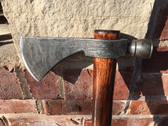

And now for something entirely different...
I was working on my BUG and had read a tomahawk can be a very useful tool. It addresses defense, cutting wood, use as a hammer for tent stakes, etc.

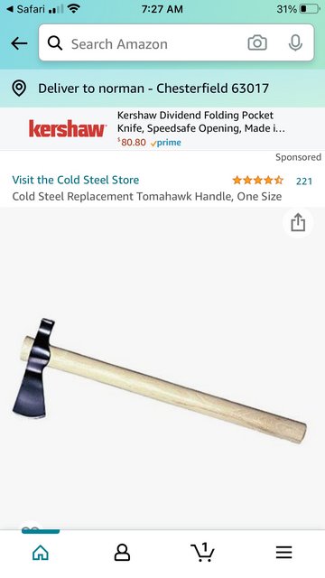

I found one on Amazon which fit my budget. The model is the "Pipe Hawk" from Cold Steel. I chose it because of the axe blade on one side and a hammer head on the other side of the head.
When it arrived the head was quite wobbly. That didn't make sense to me so I did a quick google search. What I found was literally everyone who has purchased a Cold Steel (CS) tomahawk complained about the wobbly head. CS doesn't properly fit the head to the handle and uses a set screw to keep it in place.
Hence there are tons of "improvement videos" on U-Tube to fix the problem and to improve the looks of the tomahawk as well.
The videos were my downfall because I spent way too much time working on it thereafter.
So for your approval here is what a CS tomahawk (not my exact model) looks like when it arrives and the following pic were after my improvements:
The start was to remove the set screw and throw it away. Then working the handle with a rasp and sandpaper to get rid of all the original gaps between the metal of the head and the handle. To improve the grip, I first scored rings to provide a guide for burning in the rings with my soldering iron.
Next was 3 coats of mahogany stain I already had in the house. After that dried 3 coats of varnish were applied.
For the head I removed the black paint and prepped the head for tiger stripes. Using yellow mustard and a Q-tip I applied tiger stripes to the head and let the vinegar in the mustard etch the stripes. Simple soap and water was next to clean off the head. The final step on the head was to sharpen the blade.
Tomahawks are pretty cool because the head and handle are solely melded together by a friction fit. Hence the importance of the first step.
While I won't be carrying this blade daily Wink I sure check it out every day as I think it turned out pretty neat.
I hope you like it.
Posts: 4185 | Location: St. Louis, MO | Registered: November 24, 2009Reply With QuoteReport This Post
Picture of Hobbs
That tomahawk came out quite nice. Well done. Looks like an "essential edge".
