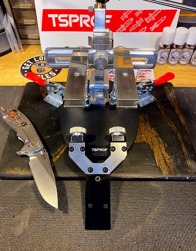

Maxamet sharpened to a mirror edge on my TSPROF Kadet.
Having been a high relief woodcarver for years knowing how to sharpen a tool to a razors edge is absolutely necessary.
But free hand stone sharpening when you’ve realized your knife collection has grown to 30-40+ knives I realized it was time to move into a faster guided sharpening system.
Something much more usable than the Lansky kit I had.
Also most of my knives are now moving into 20CV , M390, M4 & CPM-D2 range , hand sharpening can be a real pain.
The Kadet is an amazing setup.
The ability to set an exact repeatable angle is a game changer for me.
The re-zero ability between stones accounting for variances in stone thickness again is a game changer for achieving a consistent edge angle.
I keep a Sharpening log so I know what angle I’ve put on each blade when it comes time to resharpen.
I use diamond stones to set the new angle on a knife before starting up through the non-diamond stones & into the kangaroo leather strop blanks with diamond emulsions.

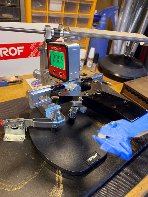

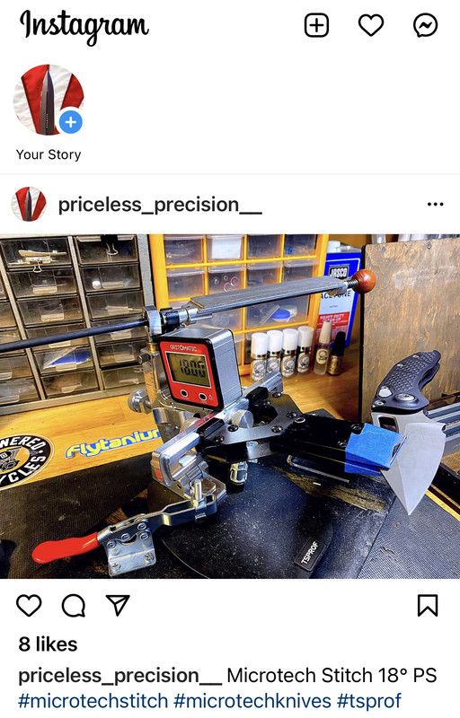

PM2 clamped, it ain't moving! Angle on both sides are dead nuts. Scratched a witness mark on the stone holder. Simply swing/pivot the holder to adjust the blade in the clamp for a consistent reveal, very easy. Also put the tip of the blade a little closer to the bar to keep the reveal the same due to the tip being thinner behind the edge.
armored, I have an older K02. Very happy with the results I get. No experience with the K03 or Kadet. Know a couple people with the K03 and they both speak highly of the rack and pinon elevation, how smooth and precise it moves. Just by watching a couple videos of the Kadet I would buy a K03 because of how rigid and stationary the clamp bar. I like the idea mechanically having the pivot move the angle vs the clamp bar. The rotation mechanism on the K02 is very solid, same mechanism on the K03. The mechanism is on indent ball bearings, it's a smart idea. I just had to take it apart to see how it worked! The tension on the rotation can be quickly adjusted to vary the tension. With stones have it fairly stiff, switch to strops much looser because of the very little pressure I put on the strop, very fast and effortless to rotate the clamp bar. Hope that helps.
I have a angle cube like Grumybiker. It too has two decimal points. If I were to buy again, get a cube with only one decimal point. Early on using it I fretted a bit too much chasing that 2nd point! Interesting very few factory edges are ground to the exact degree on both sides, some are waaaay off. US Spyderco's do a good job, ZT and Kershaw have been some of the worse.

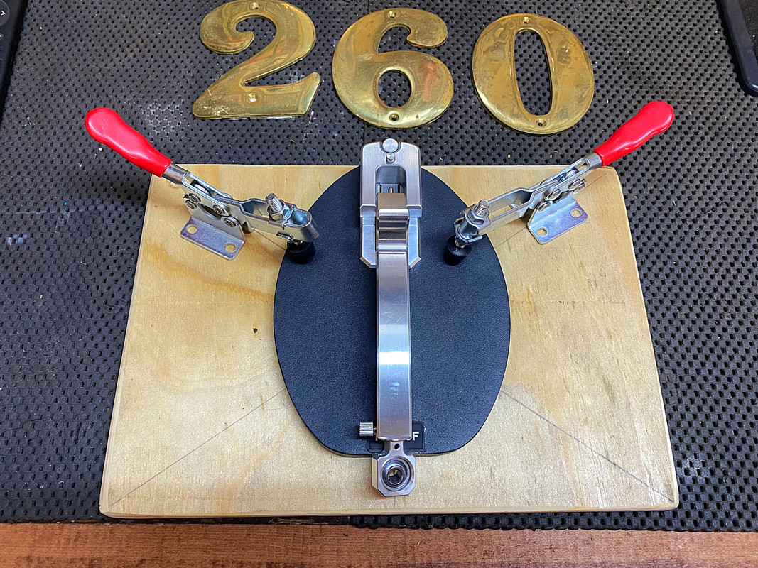

My friend & professional (business) sharpener bought the K03 after not liking the base movement he got while sharpening kitchen knives on the Kadet he had.
The larger base of the K03 stopped that .

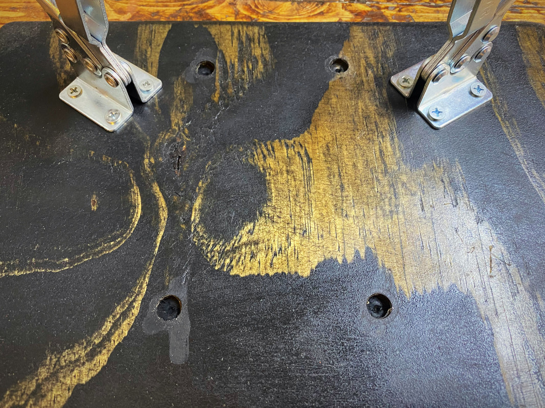

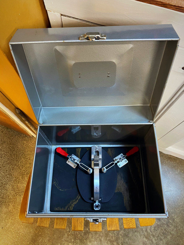

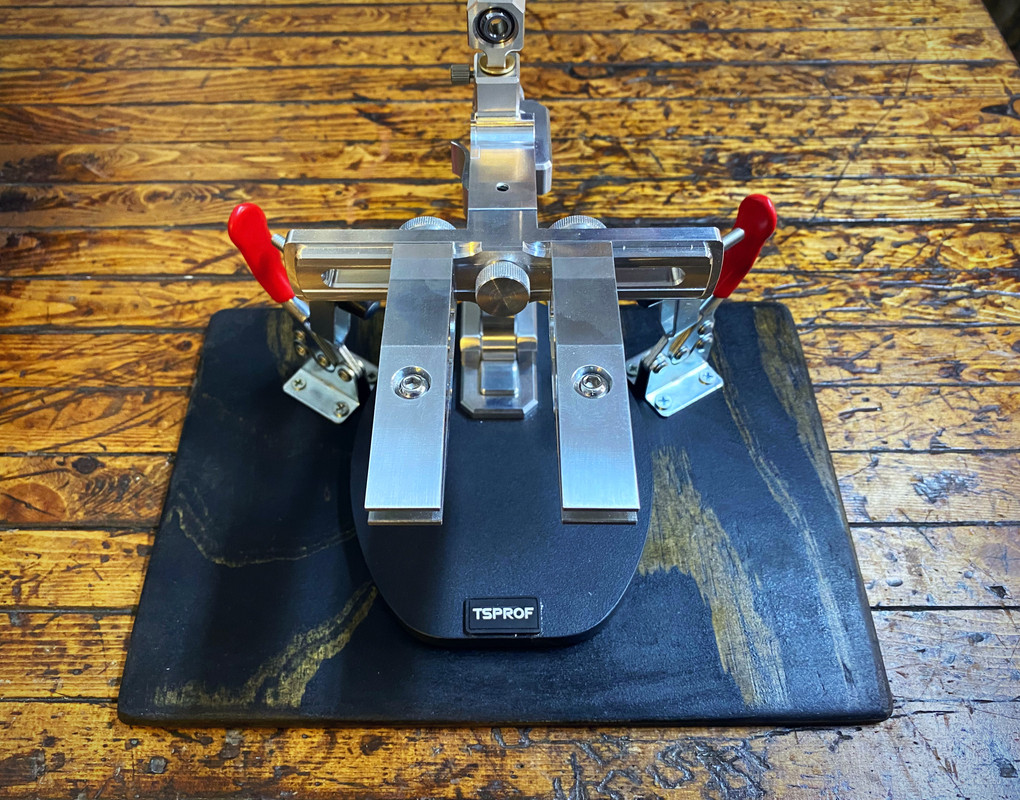

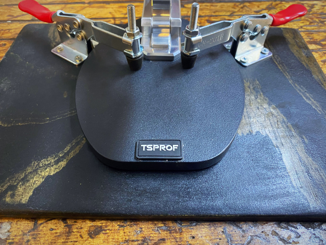

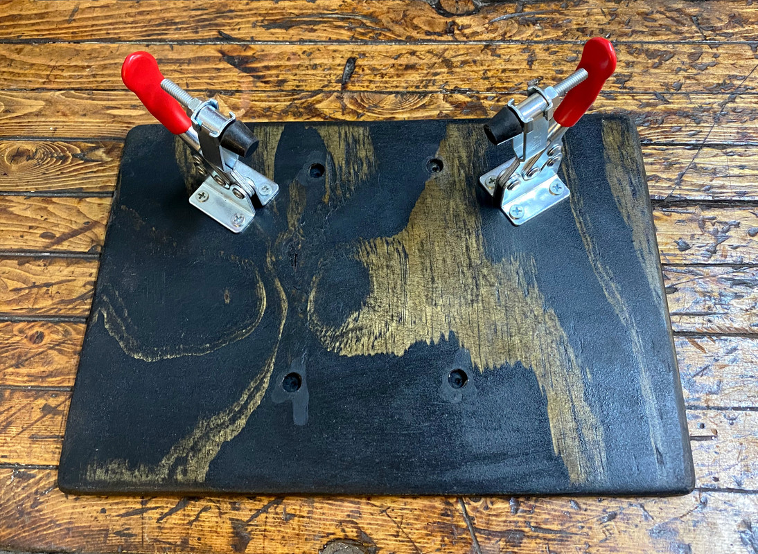

I decided that I would add a larger removable base to my Kadet as I travel in the motorhome and portability was important so didn’t want the larger model.
This is my solution and it resulted in one hand sharpening with zero base movement. I also added 2mil adhesive backed foam to the entire bottom of the base.
$4 each for the clamps, $2 for the foam sheet & plywood was scrap. So an inexpensive alteration.
