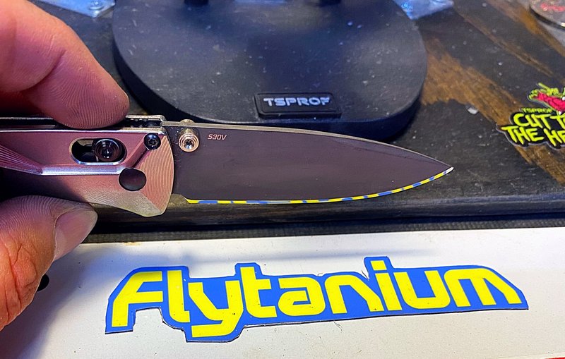

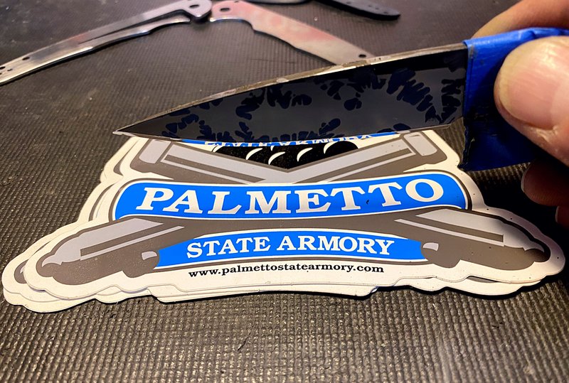

GrumpyBiker
Working on a project build & after finishing a “thorny” acid etch I used my TSProf Kadet & Shapton stones to add this mirrored edge to a D2 blade.
*I’m making custom scales from East Indian Rosewood.

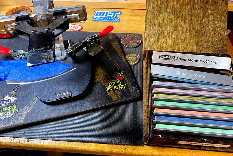

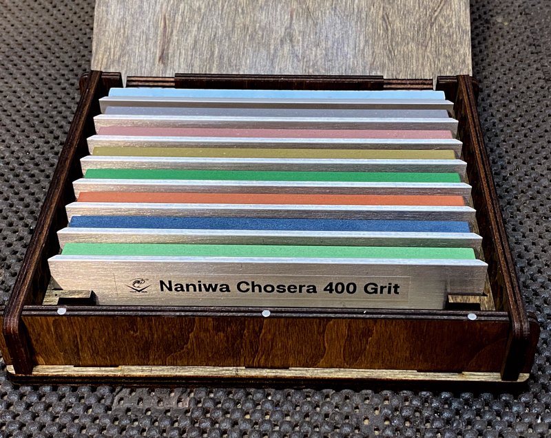

GrumpyBiker
Got another set of stones (Naniwa Chosera) & decided to give them a test drive on a new Dirk Pinkerton collab in 20CV.
Turned out okay. Wink

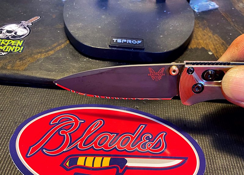

GrumpyBiker
A Bugout I’d traded for a year ago found its way into the Kadet, 15DPS.

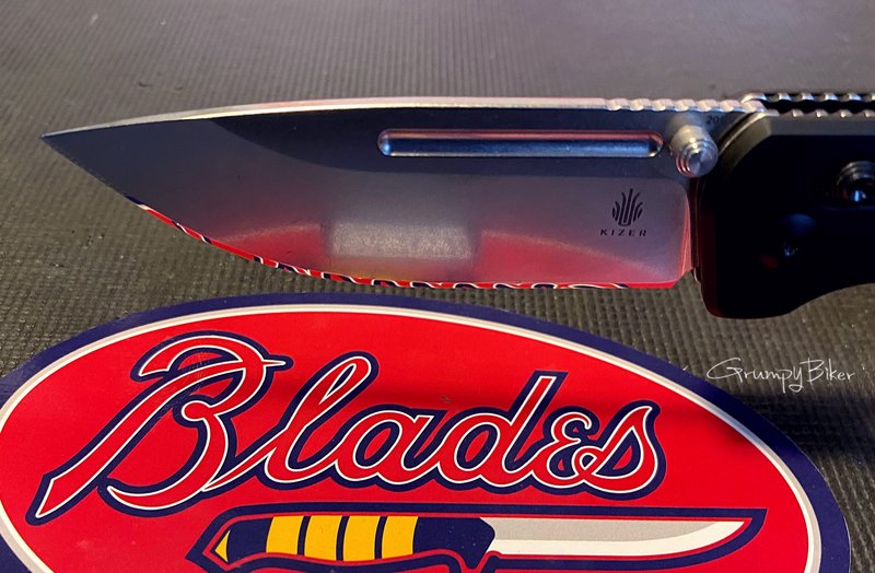

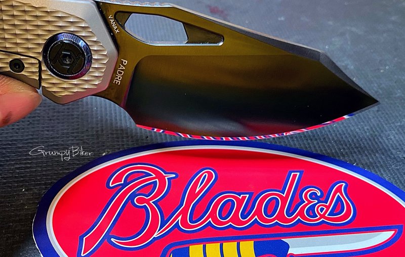

GrumpyBiker
Spent some time today at the sharpening table.
One of my Padres needed a mirrored edge Wink
Vanax is nice to sharpen.
