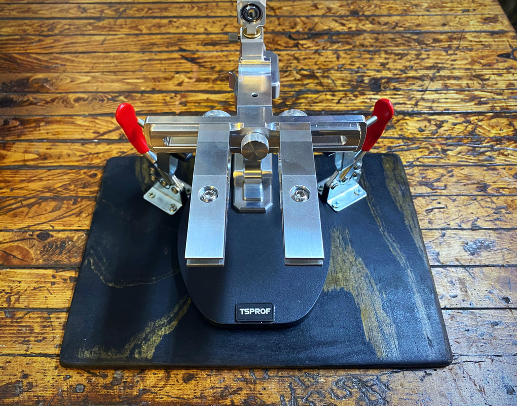

I have a TSProf Kadet, and I would love to try to do this. Didn’t grumpybiker make a mirror edge using this system?

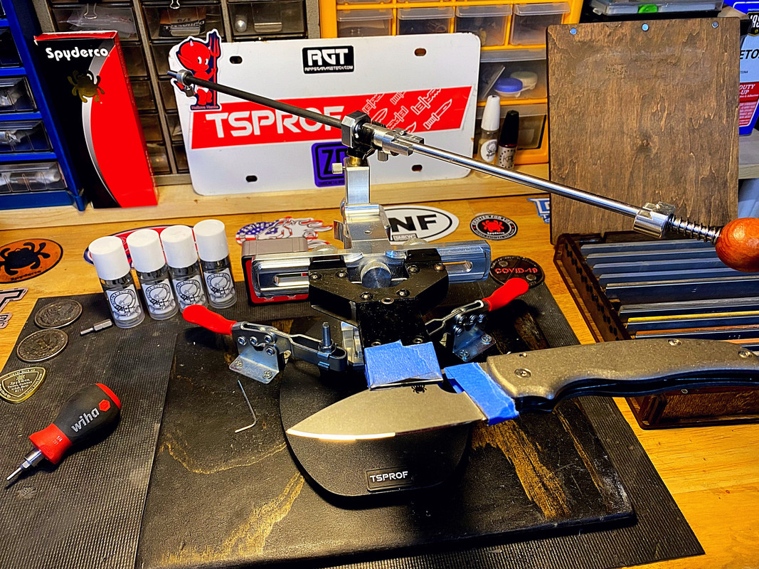

I sharpen for a fee (just a side thing on line).

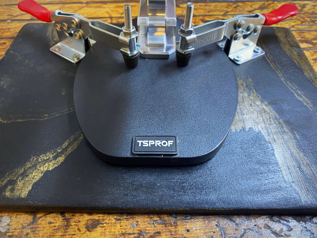

The system I settled on is the TSPROF Kadet.
Love this thing. I know you’re not a fan of FB but there are a number of “Guided Sharpening” groups on there.
I have a few friends that do this for a living many have switched to TSProf KO3 or the Kadet.
I love sharpening knives but after getting into high relief wood carving and all the sharpening needed to maintain those tools sharpening knives kinda lost its appeal.
These new guided systems are fantastic.
Easily able to repeat the angle of your choice & achieve the same angle on each side.
I do mirrored edges to show what’s available to folks interested in having their knives sharpened by me .
Using diamond stones to set the new edge angle , I then use traditional wet stones from 120grit up to 4000grit then switch to the kangaroo leather strops with diamond emulsions from 9um down to .01um I use Gunny Juice emulsions.
(They’re the small white capped bottles seen in the first two photos)
I do love the amazing sharpness of a mirrored edge. Smile

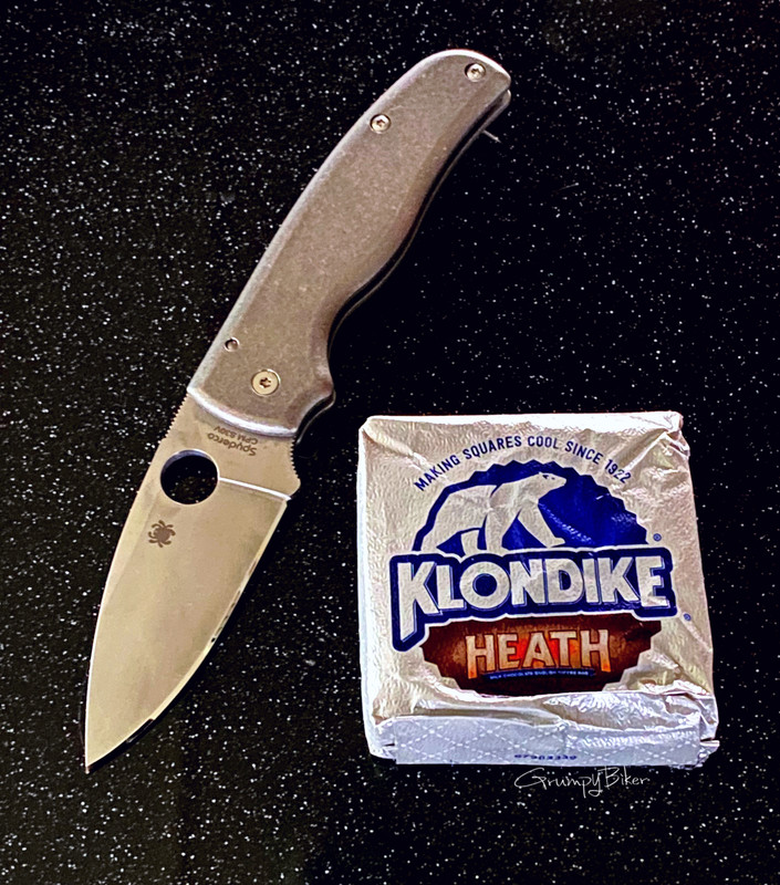

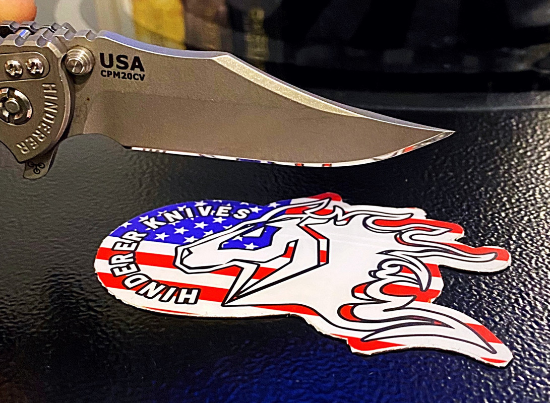

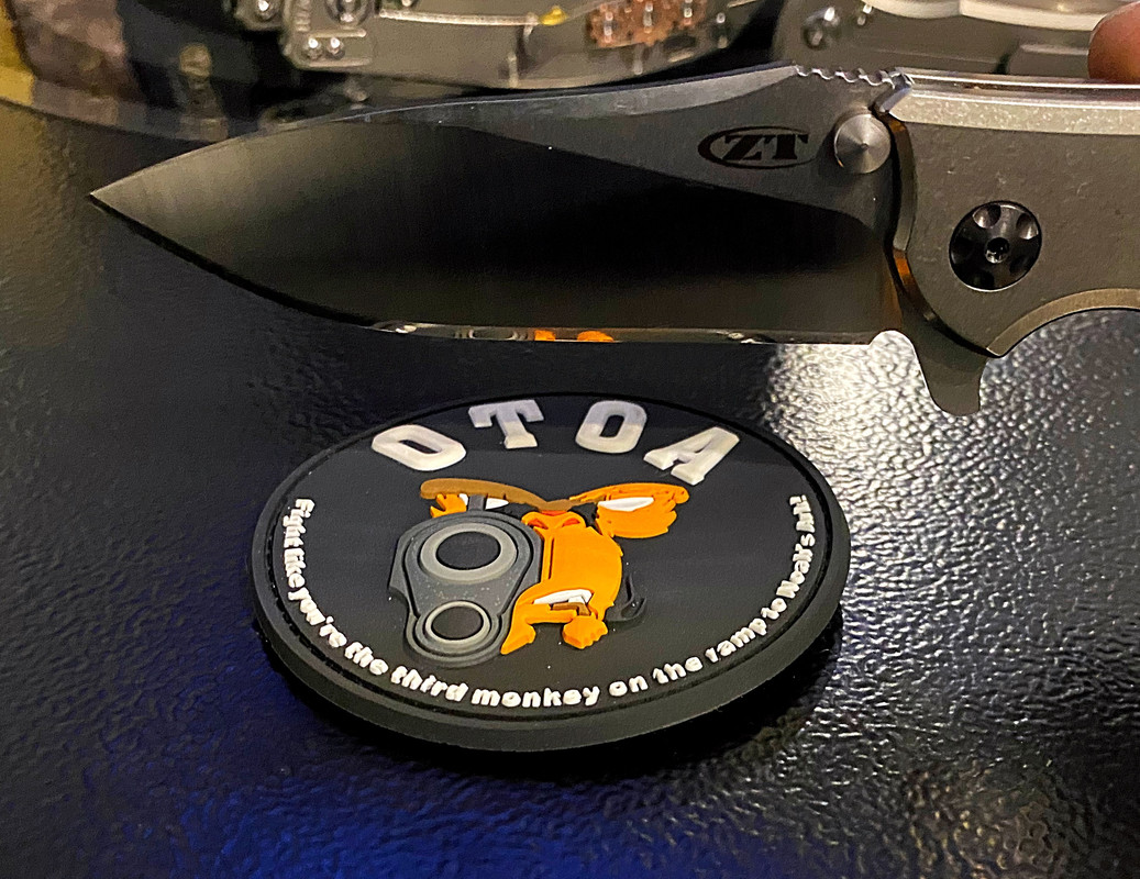

Since this topic doesn’t come up often I’ll take this opportunity to post a couple of mine! Razz

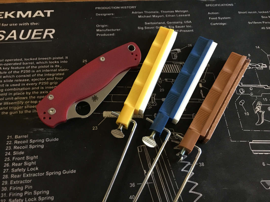

I've done it with a simple Lasnky five stone set, working to the finest grit stone.

Lansky does offers some higher / finer grit stones and a leather strop for their system.
If folks don’t want to drop the $500-$1,000 to get into one of the better guided systems.
I’d recommend multiple leather strop like the one in the photo for each different grit diamond emulsions used.
I haven’t used this set up in years.
