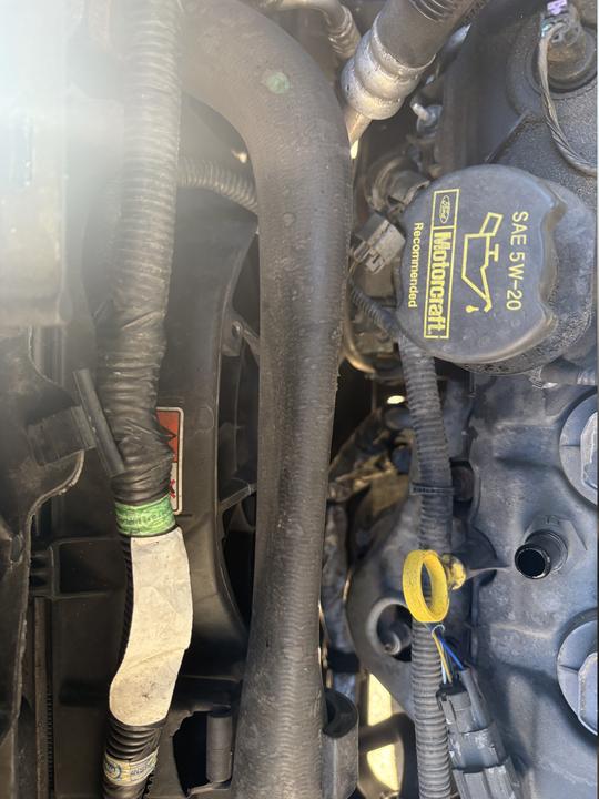

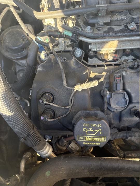

I was changing the spark plugs and transmission mount today and on the left side of the front valve cover there are 2 sensors (I presume) oil seems to be weeping from those sensors.
Small area on the valve covers are slightly wet from oil. And it seems to be coming from these sensors.
There are no other oil leaks on that valve cover all 3 spark plugs were dry, no oil in the spark plug well and the coil boots were dry
The back valve cover and these sensors (I presume) are as dry as a bone.
I also replaced the PCV valve while doing the plugs. One of the ignition coil wire connectors was super brittle and broke. That looks like a pain to repin and $35 for the Ford connector!!!
But anyway. What need be done about those wet sensors?

VVT/Cam sensors?
IIRC both our Flex & my sister's Edge had some seepage there, never more than a small bit around the sensors.

As for those VVT solenoids (which barely even seep), you have to determine where the seep is. They can leak externally around the seal (for which you have to take the valve cover off and install seals, as well as a new gasket with spark plug tube seals; IIRC they come in the kit), or internally. Pull the wire connectors and see if there's oil inside.
Picture of 4MUL8R
Why are the other two sensors not leaking?
Hmmm.
