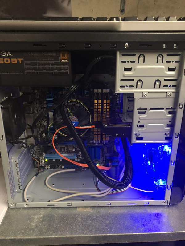

A little while back I had posted about wanting to build a PC for the cameras. Low and behold I got a sweet karma email from member Xero offering me an Asus motherboard, Intel i7 processor, and 16 gigs of RAM.
I added a case, power supply, WD Purple Hardrive (supposed to be the best HD for camera setups).
After a couple dumb questions to Xero after putting everything together (never built a PC before). I got Windows up and running did all the updates, added a couple of virus and malware programs. Then saved my settings from the old BlueIris setup from the other machine. Loaded BlueIris onto the new machine and everything was up and running. My CPU usage at the moment even when running Youtube videos in a browser runs between 10-20% so needless to say this thing is smoking compared to before.

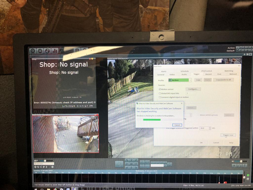

But whenever a camera is triggered be it my the motion trigger or the force trigger button in the program BlueIris just shuts down immediately. No chance to send alerts or anything just closes the program.
The other thing is when I open up the BlueIris Software on my phone it says "For optimal performance, please update the BlueIris software on your PC." According to my settings on the PC it is up to date. Even if I click the update button BlueIris on the PC it says up to date.

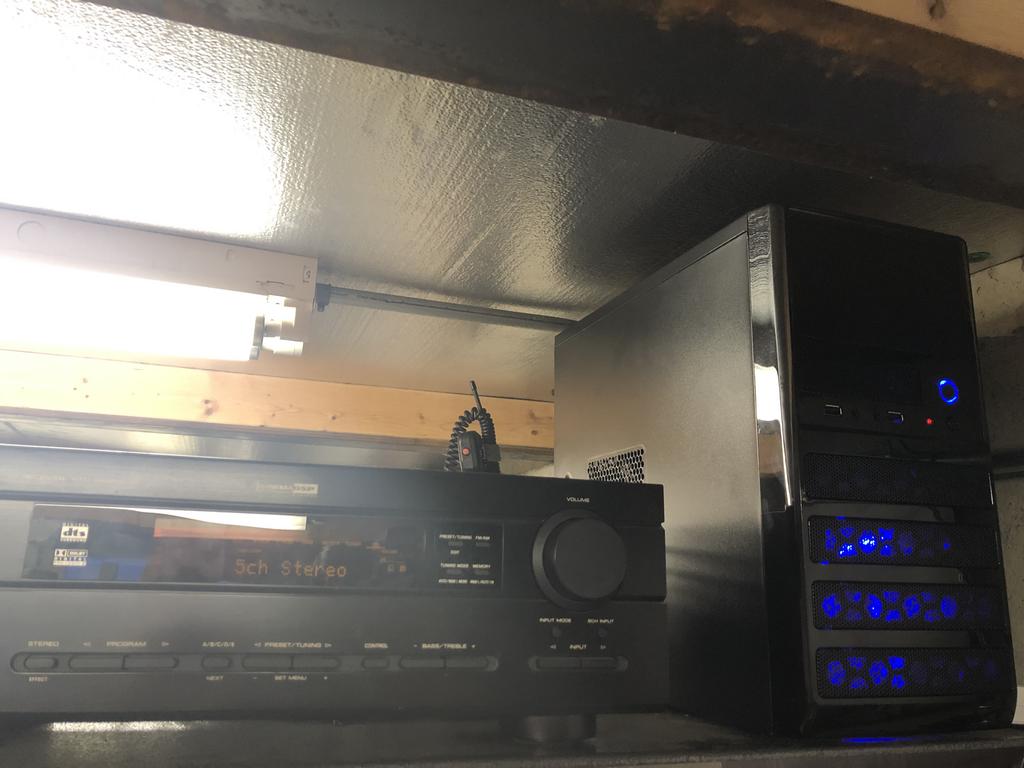

No need to make fun of the cheesy blue light. The case was $20 and I did not realize it lit up when I bought it.
That is what I get when a camera is triggered. Yes, I know one camera is not running. That is the camera in my shop where I have the PC and my boys are out here playing so BlueIris won’t stay runningbsince they are triggering the camera.
