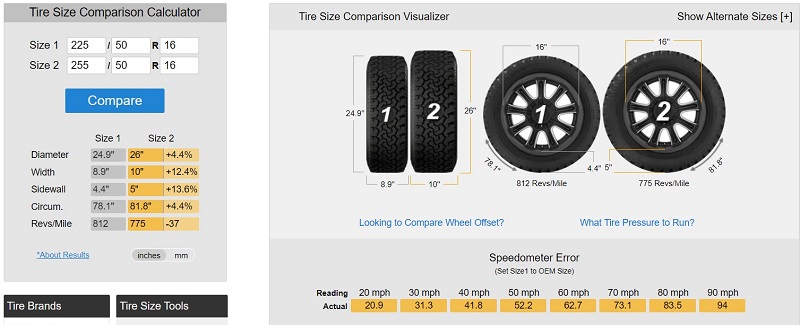

I think you should look up the 225/50/16 circumference & find a 255 tire with the same circumference. Also the rims may be too narrow for a 255 tire.
Circumference difference is about 4.5" & diameter diff is about 1.5"

The diameter change will affect the performance as much or more than the difference in width.
I don’t believe there is such a thing at least in 16” tires.
I have not seen anything less than a 50 series tire in a 255 width.
