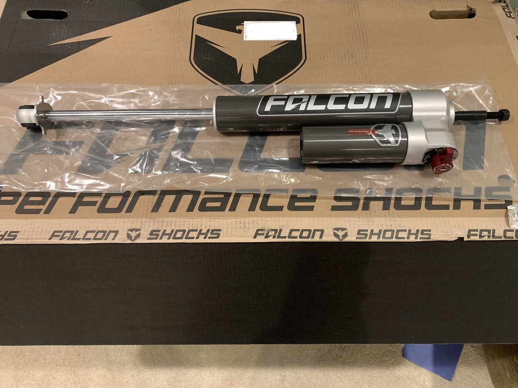

Ordered way back in November and they have finally arrived!

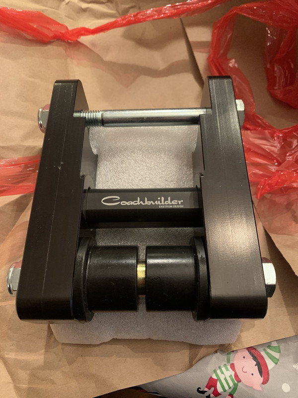

Holy shackle Batman!!! I’d go to say it is a work of art!

Ordered these Falcons in November for a very nice Black Friday Deal. I did tons of research on all my options. I found that the Falcons would be the best option for me and my use of the truck.
I initially was put off by reusing the factory spring but this kit really seems to address the issue of reusing the factory spring and gaining lift from preload vs. a lift spring. The external up travel bump stop and internal progressive down travel bump stop should remedy the issues. Being that my off-roading is more slow with mild articulation Jeep styled trails vs. the high speed Baja stuff that Fox, King, and Icon are more geared towards.
Falcon is TeraFlex shock line and TeraFlex has been in the Jeep game for a long time and is very high quality.
Know a few folks with Falcons on their Jeeps and are nothing but happy and everyone that has them on their Tundra is very happy.
But these two video really sold me on them.
This video breaks down a Fox and Falcon shock side by side showing how much better components go into the Falcon over the Fox.
This video is a factory tour showing how much care a quality go into these builds.

Falcon Shocks will give me 2.25” lift in the front.
Coachbuilder Shackles with Poly Leaf Spring Bushings will give me .685” of lift in the rear

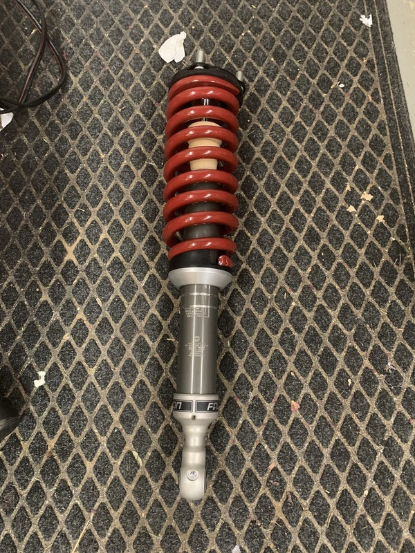

Had the fronts assembled today and ran into a little issue.
I don’t feel like using the crappy rental spring compressors and don’t feel like dropping the coin on a good compressor to use only once.
Figured I would shop it out to be on the safe side.
Well, they got them assembled but everything is side and/or orientation specific. Said they could not get the proper orientations without damaging the powder coat.
The pigtail is 180* from where it is supposed to be and the top hat orientation is also off if I just rotate the body then the zerk will be off and the spring will still be pointing the wrong direction.
Hard to tell from the coloration in the picture but the spring is not seated properly in the bottom perch.
So need to find a place to reassemble it.
Posts: 26280 | Registered: September 06, 2003Reply With QuoteReport This Post

And we are setup proper. Here is hoping for some decent weather soon. Calling for a bunch of rain this weekend. If I get a little clearing in the rain I’ll try to toss the rears on as they are far less involved.
