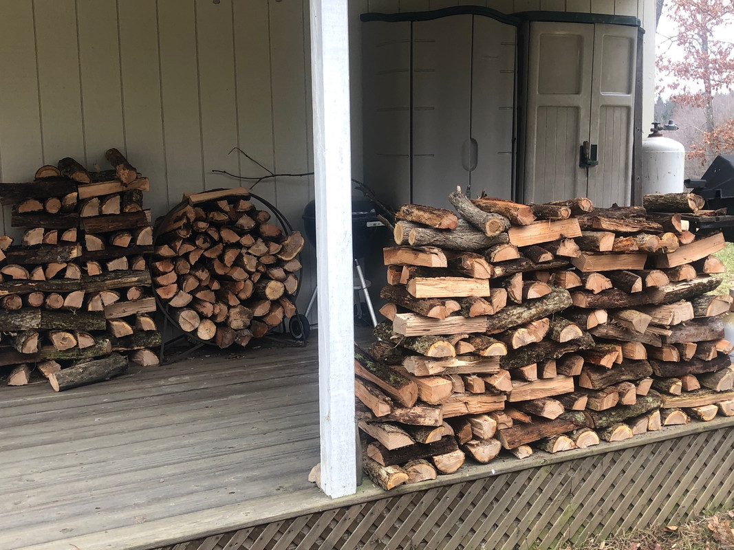

The topic of battery operated chain saw pops up here on occasion and some may wonder just how well they work and how much they can cut so I thought I'd post this.
I bought a Stihl MSA200 a year ago, mostly for light duty limbing as well as to carry in the back of my UTV to clear fallen limbs and small trees. Normally I use one of my gas saws for cutting firewood but I had it (fully charged) with me yesterday and stumbled on a couple standing dead trees. I ended up cutting up two tall ones, a 9" oak and 8-9" cherry, each of which completely filled up the bed of my Mule. Toward the last cuts on the second tree the saw was starting to slow down (down to one charge light out of four) but still had a bit left when I finished. After splitting them I stacked it on the porch and snapped a pic just to give an idea what can be done on one charge in case anyone is considering a battery saw, which in all honesty was a bit more than I thought it could do.
All the wood, that in the ring, the stack to the left, and the one at the edge of the porch is what it did.

That's about what I've done with mine before going to 1 last light. It does get slower.
More to the point, that's about all I'm good for at any one charge.
Thanks for the photos.
