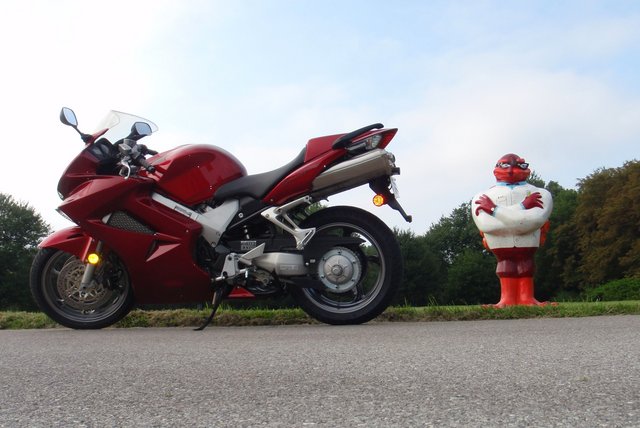

Alas, there's no kick starter on the VFR800. Razz

VFR 800…The best motorcycle ever, (IMHO)!
