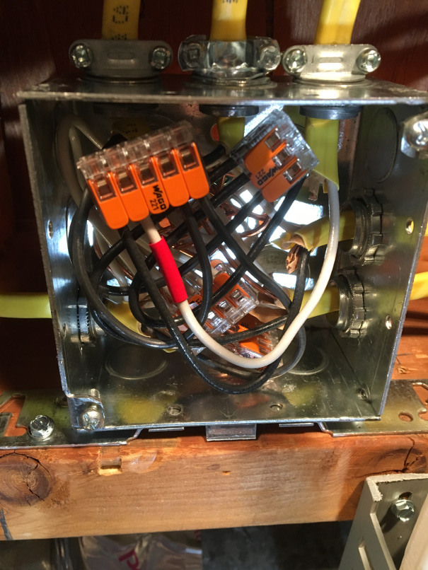

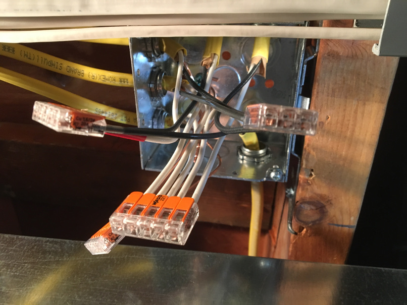

Like this?
Same box, stuffed:

Perhaps if I were building homes or doing electrical contracting I might feel the same, but I'm not. Wago connectors are easier, faster, sometimes neater (see photo, above), and, by some accounts, safer.

What I did have happen, once, was one of the terminals lost it's mechanical integrity. As I as stuffing the box (might have been the one in the photo) I thought I felt something that didn't feel quite right. Pulled it back out and re-checked everything. Sure enough: One of the terminals in one of the blocks was sprung.
That was a fire hazard, btw.
Maybe it was a defective one. Maybe I over-stressed it. (Fracking 12 ga. is like wiring with coat hanger - grrr.) Dunno.
