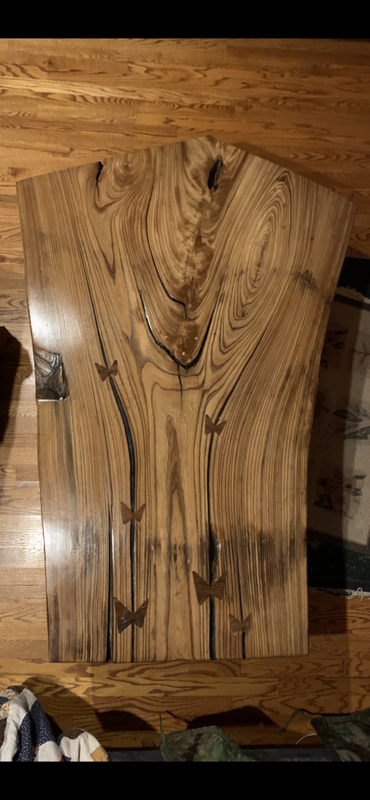

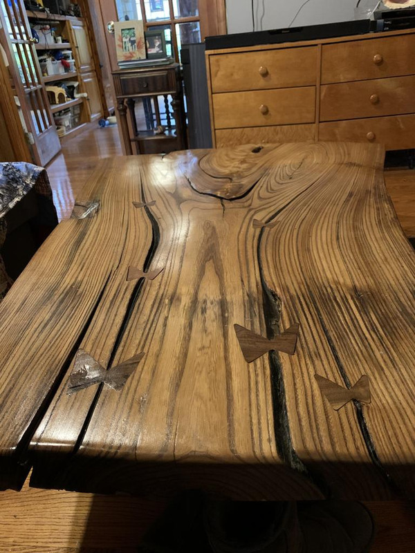

Quick background- my wife’s step father has been making custom furniture for many years. He basically travels and locates large examples of American hardwoods to work with and turns out some amazing creations. Back around 2002 he gifted us one of his early creations that needed some work. It was made from the center cut of a standing dead American Red Elm (now basically extinct thanks to Dutch Elm Disease). I refinished the table and gave it 5 coats of Tung oil.
post pics

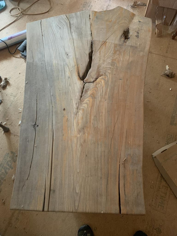

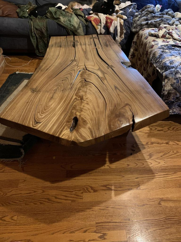

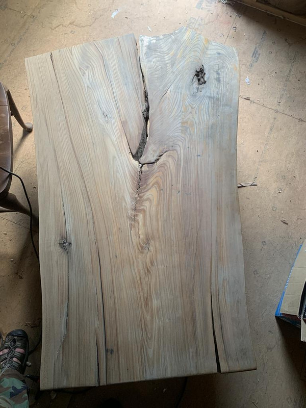

My wife’s mother passed in December 2011. Prior to that, her son created a table from the same pile of Elm slabs that she enjoyed for several years. After she passed away, her husband had a severe stroke and fell under the care of a caregiver of his choosing. This woman was nothing less than a harpy that kept his possession in a leaky old barn until last year when he himself passed away. The caregiver contacted us to arrange disposing if his now nearly damaged belongings, including the sister-table to the one we have. It was in atrocious condition when it arrived.
photo upload on web

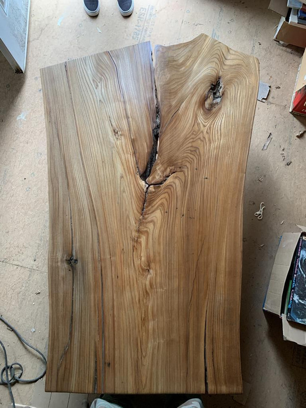

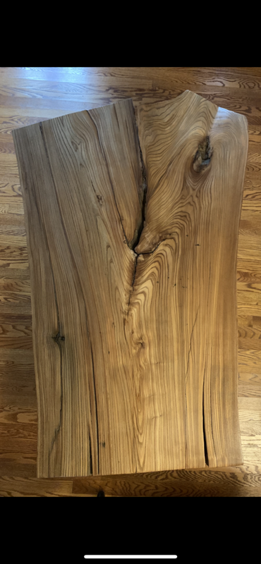

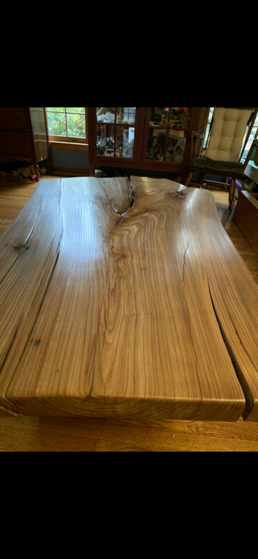

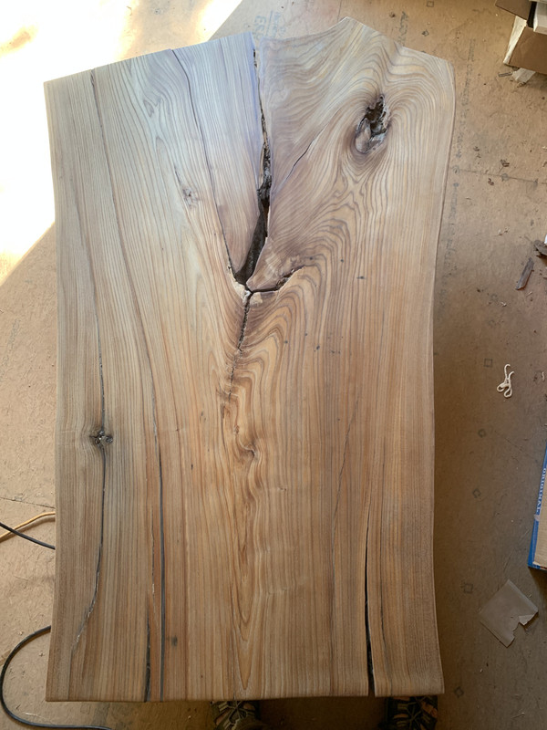

I set to work with sanders, beginning with 80 grit sandpaper Eek which was necessary to break down the oxidized wood and level the extremely hard Elm. Compounding issues were tiny spots of rot and a shadow in the upper right corner from something left on top of it.
Once I got the worst of the damage scoured away, I was able to move up to 100 grit, 150, 240, and eventually 320.
2 coats of Tung oil later and it’s ready to move into the house.

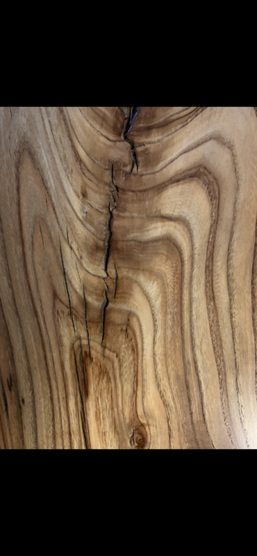

It’s not a finished project yet; one leg is loose from careless handling and storage, and it needs a few more coats of Tung, but it is vastly improved. Both tables have amazing figuring and pictures don’t do them justice.

Those are beautiful!
Posts: 16245 | Location: VA | Registered: July 15, 2007Reply With QuoteReport This Post
Great looking, especially the first table's butterflies. Awesome that the stepdad made the effort to individualize the butterflies with different perspectives/angles.

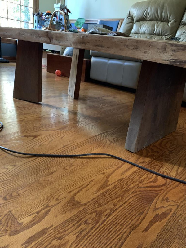

If/when you get a chance, please post a pic or two of the legs.
I'm a leg man...

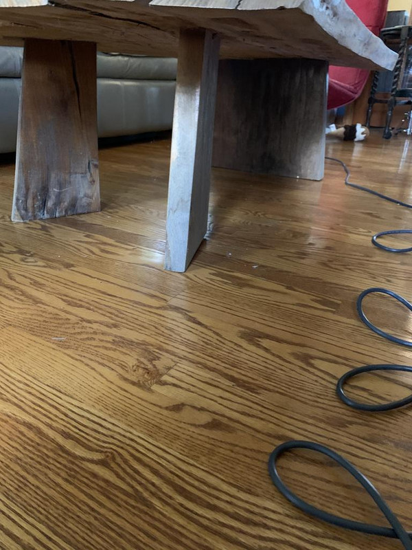

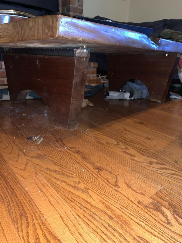

Both leg set need some love
Table 1
Table 2

The step father favored the stylings of George Nakashima and strengthened these butterflies with matching underlying steel pieces to insure the wood would stay put.

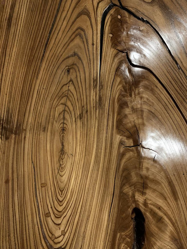

Very nice! Have you thought of inlay for the voids in the wood? There are many pics on Pinterest showing finished tables.

We’re going to keep them au naturel as possible to keep as primitive as possible. We thought of doing possibly clear epoxy fills but it would be a tremendous amount of finish work that you only get one shot at without possibly screwing it up.
