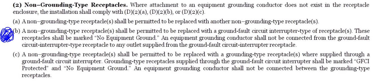

Would leaving the wiring (non-grounded) and replacing all the outlets with one of these be a viable alternative?
It looks like it is technically NEC compliant if you label them as non-grounded. Cost about $500.
https://store.leviton.com/coll...?variant=23948191299
yes, you may have this as an option: (Warning, this was taken from an older book and may not be current or even apply to your region)
