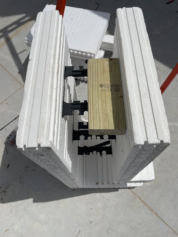

Why limit yourself to one room:
The foam is 2.5” on each side and the middle is 6.5” of poured concrete with horizontal and verticals rebar all over. Supposed to be good for 300mph.
There are options if you can’t have a basement:
