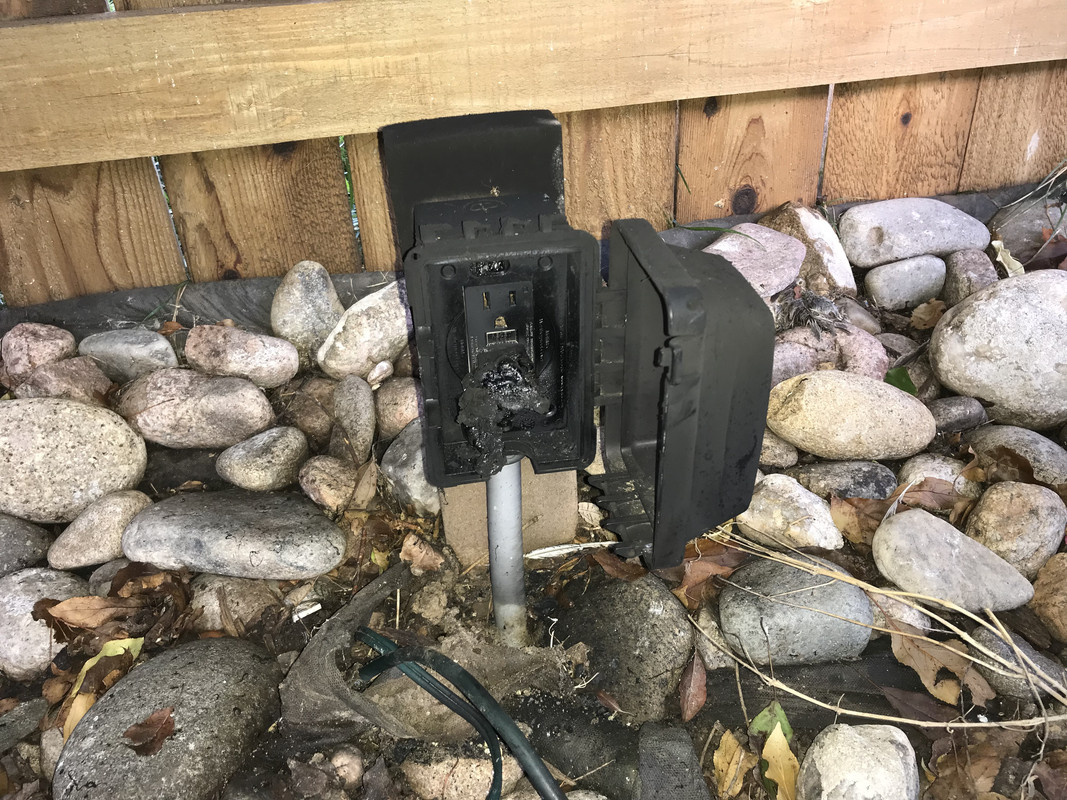

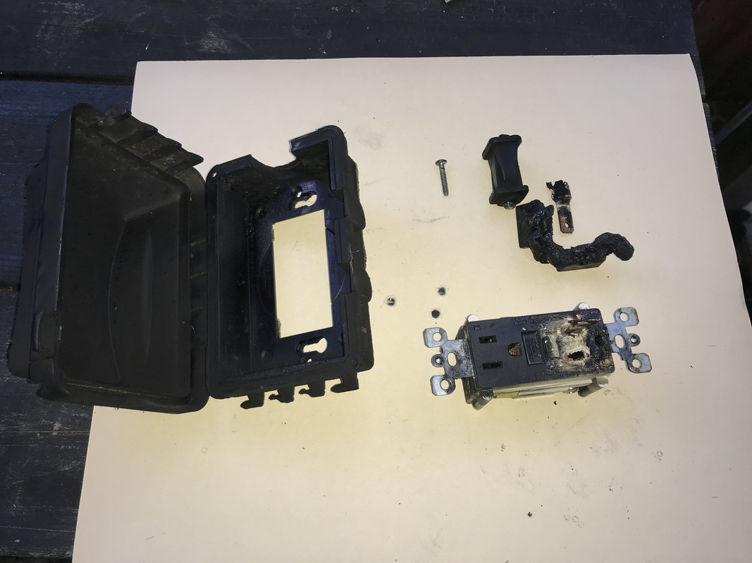

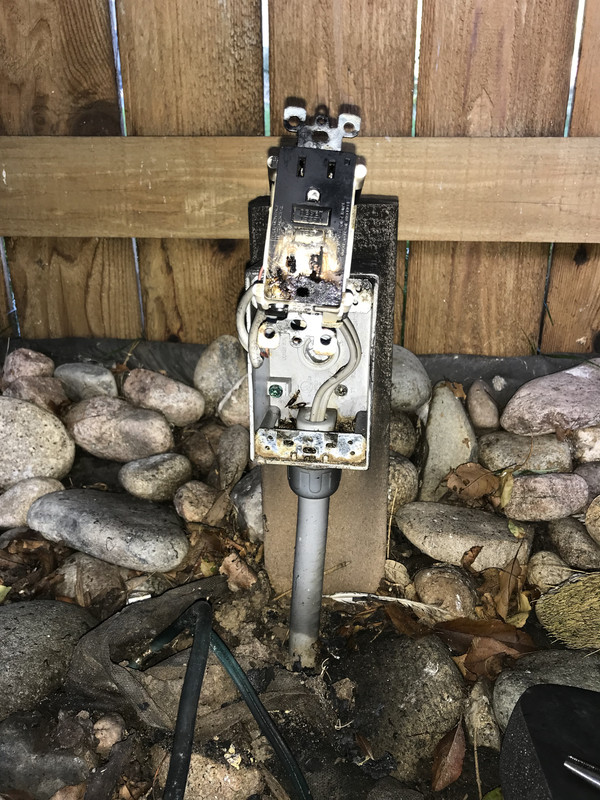

So we had the birdbath and a string of decorative lights plugged into this GFI protected outlet. I found a ton of dead and alive earwigs in the bottom of the outlet box. We had a bucket over it to keep all the rain off/out of it. The 15 amp circuit breaker in the main box did not trip. Any ideas folks?
Moisture induced corrosion, then high resistance, heat and failure.
(slow burn, no ground fault)
Thanks Monkey. I've just never experienced one get this outta control. The smoke was horribly acrid too.
I prefer CGFI breakers over outlets, and don't mind the cost and time to replace them.
Have had multiple issues with outlets years ago, and never had trouble with a breaker.
I have had regular breakers go bad, but very few.
In Florida it was the house geckos that lay eggs and get zapped when they touch exposed brass screws on the sides of outlets and cause havoc with outside facing outlets.

Hard to see if that was a wet location box, but if not definitely get one. It doesn't look like that was, perhaps just an outdoor one. They are different.
If you knew you needed a bucket, sounds like you definitely need a wet box.
