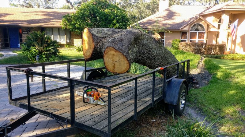

I have an older MS260 saw as well and it is the boss when it comes to chewing up the trees I've unleashed it on. And though Stihl would probably recommend against it , I took this almost 30" fallen Oak down to the ground with my MS260 sporting a 18" bar. Took a while, but it just kept chugging away. Smile Biggest recommendation is to get a chain sharpener, learn how to use it, and use it frequently to keep your chains sharp.
