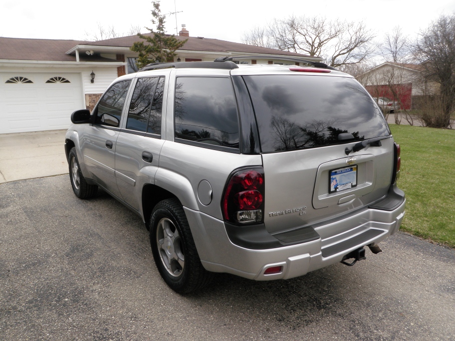

I have a 2007 Chevy TrailBlazer with about 135,000 miles. It's mechanically sound, the interior is still in nice shape and the exterior still looks really sweet. Silver with black trim. In fact...
So I thought to invest a bit of money in it, thinking $3½ to $4k, get the developing rust on the bottom and trailing inside door edges/flanges mitigated before it got too far, and a few other finish dipsy-doodles, upgrade the electronics and keep it for another five years or so.
Body shops' (two) verdicts: The inside door edges are marginal, but, the real show-stopper is tiny bubbles in the paint in the trailing lower corner of the outside of one of the doors. That means rusting from inside. If one's doing it, its nearly certain they all will, soon. They give it about two years.
To truly correct that problem requires replacing all four doors. Compounding the problem is it's silver paint, which means they have to shoot entire sides in one go. I'd be looking at $6 to $7k to correct it all, now.
Doesn't make sense, but...
What if I were to invest about $1500 in fixing the currently exterior-visible issues (dings and scrapes) and the radio? Then, a couple years down the road, when the door rust starts to show, re-evaluate and then decide whether to spend about $5k to have all the doors replaced? There's no other rust anywhere.
Thing is: I really, really like this truck. I truly do.

I say drive it as is until it starts costing you money. You live in MI, everybody has at least one rusty shitbox
You could drive down to GA and buy a rust free one for the amount you are talking about investing.

I'd look for something with no "developing" rust.
Rust is always the deal breaker with me.

You have another option that is somewhere in the middle of the 2.
Have the lower portions of the doors and your rockers LineXd.
It will encapsulate the rust yes the rust will still spread underneath the LineX but it will not be visible. The way LineX is made the LineX will hold it's shape even as the metal rusts out and deteriorates underneath.
I just got a 17 year old Silverado with 93k miles I put on new belts, pulleies, universal joints, and A/C. The thing runs like a new sewing machine.
Only problem is the rockers are beginning to rust. Looking at $3500 to replace and repair. Having the doors and cab LineXd up to the molding strip and the rockers done is going to cost me $600.
This is a known issue with Silverados the folks at my local LineX have done it many times and most are far worse than mine. He has trucks that he did 8 years ago and one would not know the rust is there.

I drive a 20 year old pickup, so I have no natural bias against saving an older vehicle. That said, I don't think of a Trailblazer as being worth spending 3-4 grand on fixing it up. Just drive it as-is a few more years then throw it away, the way GM intended. Chasing the rust devil is a waste of money in my experience.

Hmmm...
Guy at work, him and his dad wrench on stuff all the time, told me the truck is definitely salvageable. When I told him of the bubbles in the paint he made the same recommendation.
Closest LineX place isn't close, but, it isn't all that far away, either. I think I'll give 'em a call.
±$2k to repaint bumpers and hatch, LineX the doors, a new receiver, and a pair of speakers I think would be very do-able. Drop replacing the back window (bad defroster wires) and backup camera. I've been living with(out) those. No change.
Thanks for the idea, Black. Thanks, everybody else, for your input and votes, too!

Continue to cruise with the Line-X treatment.
Price a new Tahoe and you will love your old T-Blazer even more!
