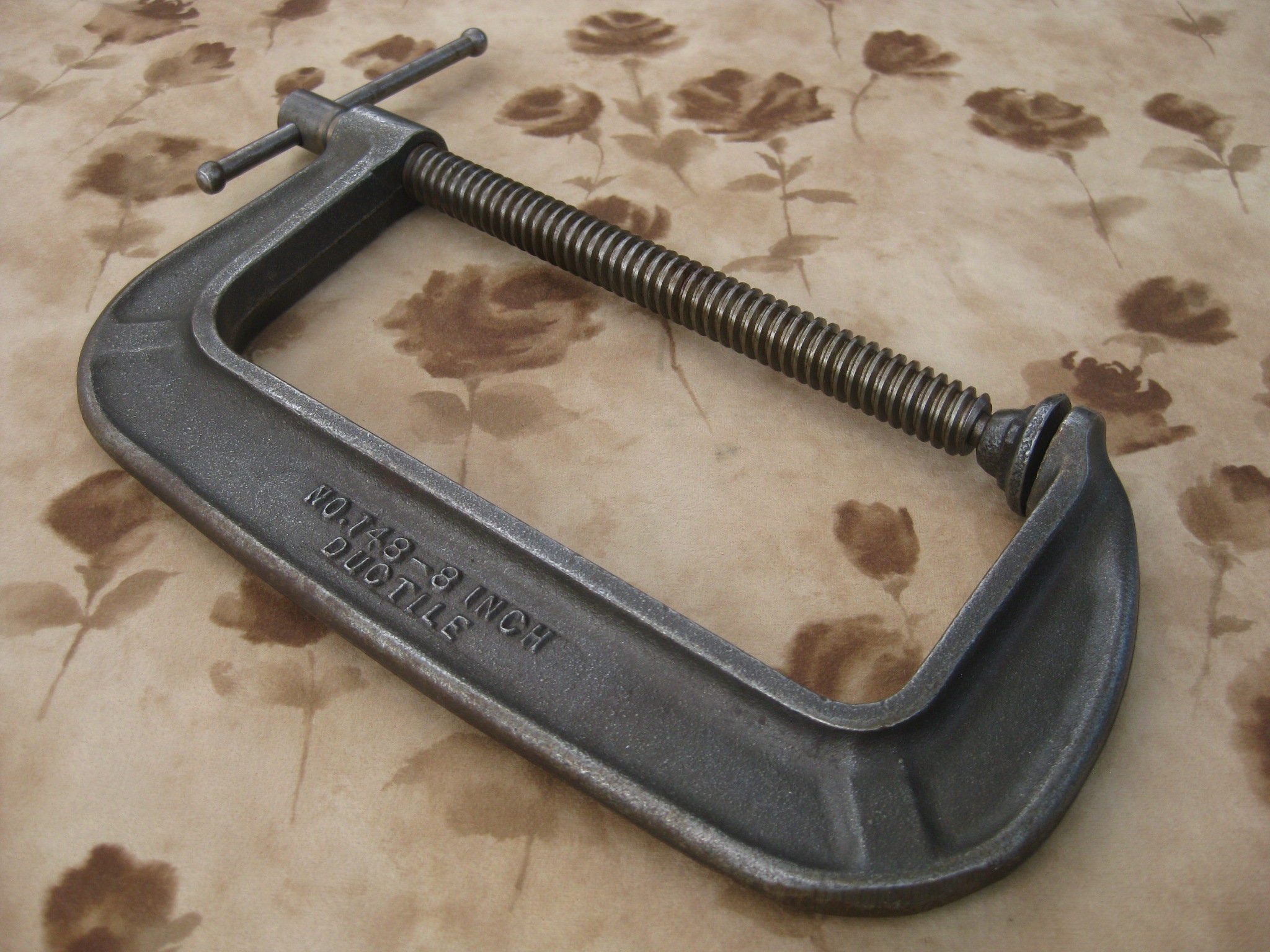

Before that I just used a large C clamp and one of the old pads. Which is what I went back to afterwards. Works better IMO. Plus you can use it as a clamp. Smile

I don’t think you want to use the c clamp method on a win back as you can damage the mechanism. Regarding the cheap kits, should be ok for light use. If you are using them regularly and want it to last I would look into an OTC, Lisle, and of course snap on but not worth the premium imo.

I dont know if it will work with winding action but the brake pad itself is stationary.

It won’t work properly on the winding pistons.

Do we really need a gigantic photo of the common c clamp?
Especially when it WON'T do what the OP is asking from a tool?
