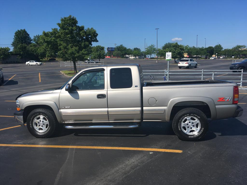

Nearly 20 years in Ohio will do a number on a vehicle no matter how hard you try. Especially since they started using the salt brine pre treatment crap.
I had the rockers done last year as they had perforated both sides. Had full rockers and cab corners (not the slip on patch panels) done. Had truck bedliner sprayed on the new sections and then body color matched the paint hoping not to have the rust issue in the future.
My mother uses the truck in the winter as she did not have a 4wd. Well last winter the parking brake cable snapped so she took it in. Rear brakes on these Silverados are prone to rust as well and were in pretty rough shape so she had new parking brakes, rotors, pads, calipers, hard lines, and soft lines done. So pretty much the entire rear system done.
I have the truck for the warm weather months and now likely pretty much all the time now that my mom bought an Explorer a couple months back.
I make a number of trips to our cabin which is about 100 miles away so I had some free time the other day and have been checking things over.
And I come across this
The backing plates have completely rusted and are pretty much gone and the parking brake hanger/bracket are flimsy as all go get from rusting. These parts should have been replaced when they had everything else out being replaced. Now, I get to tear it all down to do it.
Which brings me to the part name question any idea the name of the bracket/hanger that holds the parking brake cable and the brake line?
I am not finding that particular part anywhere and don’t think sandblasting and repainting will leave me a very strong part.
So here is the list of what I need to do thanks to rust:
The backing plates and whatever that bracket/hanger may be called.
The spare tire is stuck under the bed. I am not sure it has ever been down. The spare wheel is rusted beyond belief so a new spare wheel/tire along with the tire hoist will be swapped out as well.
Going to pull the bed (should not be too bad as it was just off for the rocker and cab corners. Going to do a Raptor Liner spray in bedliner myself in the bed and the complete underside of the bed.
With the bed off I’ll have lots of access to the frame and rear end so I am going to clean up the rust and use Eastwood Rust Encapsulator and then paint over it with their underbody black paint.
