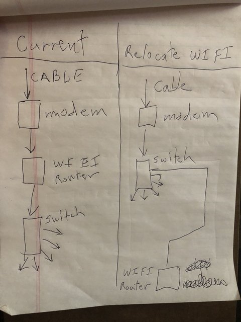

I would like to relocate my WIFI router by about 40 feet to get it away from all my home theater stuff and get it more centrally located for better coverage of the house.
Current setup is on the left side of the page.
Will the plan on the right side of the drawing work?
or...
Do I need to keep the current order of cable flow and run two cables to the new wifi router location?
Only difference to me is, as far as I know, is do I run two cables or one to the new location.
Unless I am missing something better.
Doubt it matters but...
Modem is a newish Docsis 3.1,
Switch is (TL-SG116E) TP-Link 16 Port Gigabit Switch, Easy Smart Managed.
WIFI router is TP-Link AX6000

You need to keep your Router between the Modem & the Switch; you could add an access point to the Switch to give you better coverage.
Disagree.
As long as nothing else is plugged into the switch that'll work fine.
It's not ideal - but from a pure networking perspective it's fine.
Disagree.
Well, yes, but he shows other stuff plugged into the switch and, unless there's other stuff plugged into the switch, the switch serves no purpose. So, in the context of the question: lkdr1989's answer was correct in all respects.
OP: Yes: You could run two Ethernet cables to where you want to relocate your WiFi router: One for CM -> Router and another for Router -> Switch. Crude, but effective and relatively inexpensive.
Picture of cparktd
Several things plugged into the switch, home theater components/2 TVs, wireless gateway for my garage door openers and some security camera stuff.
Wifi is only for our phones, including wifi calling because our cell service here is poor, and guests, grand kids iThingies when here, everything else is hard wired.
I'll just run two cables, I have plenty cat6 and the ends and tools to install them and a basic tester.
THANKS!!!

Picture of smschulz
The correct way is to simply add an access point to the existing configuration the OP listed above.
To use the second proposed configuration would be a bad idea if other devices are hard wired to the switch.
If the original Router/AP (TPLink) is not needed in that area it could be turned off (Wi-Fi).
Most end-users don't understand that "routing" and Wi-Fi are not the same thing.
Most consumer "routers" do both.
If you need information on how to configure two Wi-Fi units to work harmoniously we can address that too if you like.
It is why I always install a separate wired router and a separate Access Point (no routing).
It simplifies the configuration.
FWIW, you can use a Wi-Fi "router" just as an Access Point by only connection the LAN ports to your LAN and not using the WAN port (what the Cable Modem plugs into).
PS...You could just run longer cables to the desired placement point:
Cable 1: MODEM~ROUTER
Cable 2: ROUTER~SWITCH
Then move your "router" there.
Posts: 23915 | Location: Houston, TX | Registered: June 11, 2006Reply With QuoteReport This Post

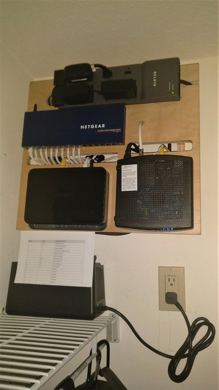

Picture of bigdeal
Beat me to it. Smile And get a WAP with POE (Power over ethernet) and all you'll need to do is run one CAT cable from your switch to it. I did exactly this and placed the WAP in the center of my single story home on the vaulted ceiling in the family room with the CAT cable running through the attic. In my seup, WiFi is turned off on the router. Nice clean and simple install and great WiFi throughout the entire 2,500 sq ft house.
And then when your OCD kicks fully in, you can stuff 'all' your network equipment into a closet, run power into the closet and up to the equipment, build a wooden 'rack' setup for all the equipment, and power everything with a UPS for power outages. Razz Smile

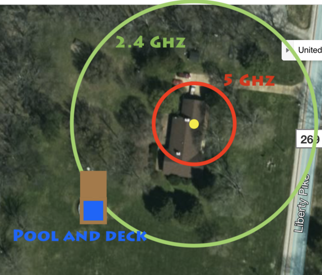

Picture of cparktd
wifi router is yellow dot.
current location and aprox coverage. 5Ghz not useable in the bedrooms. 2.4 BAIRLY reaches pool deck...
potential tweaked location...
Posts: 4500 | Location: Middle Tennessee | Registered: February 07, 2013Reply With QuoteReport This Post

Picture of bigdeal
[IMG]pic 1[/IMG]
[IMG]pic2
I still think you're asking a lot of a single router given the distances you need to cover.
That was my thought.
I've got a pretty decent WiFI AP, centrally located in our 1300+ sqft. ranch. We get solid coverage on 5GHz and 2.4GHz throughout the house. Even into the corners of the basement and garage. The patio is ok at 5GHz (and, of course, 2.4GHz). But at the µBarn, about 50-60 from the back of the house: 5GHz is out of the question and 2.4GHz is marginal.

Picture of Oz_Shadow
Perhaps a Ubiquiti UniFi access point would improve things with minimal effort. Everyone needs a spaceship.
What I'd try before you ran any wires would be to move the WiFi router to your intended new location and see if the devices you'd like to connect to it will. Use an extension cord for the AC power if you need. This way you can try multiple locations with minimal effort.
