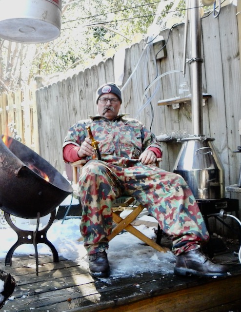

I've got one (behind and to the right of me in the picture below) but it might be a little more than you need.. also it would be better for making one of the other items in your washer fluid recipe.
