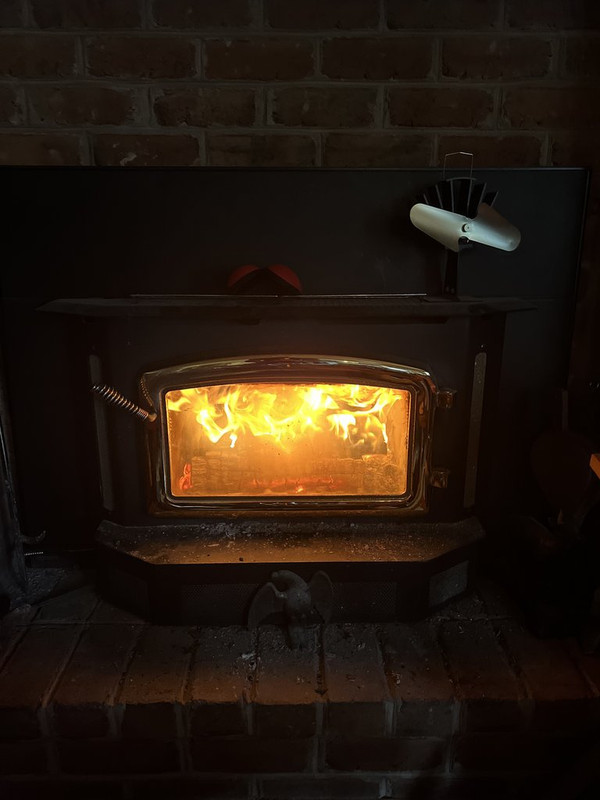

Get a high efficiency fireplace insert. You’ll realize the highest output of heat of any of the options you’re considering and newer stoves are not only efficient at squeezing every usable btu out of the wood, but they are excellent for completely burning fuel as well. This adds up to more heat and reduced emissions which equates to reduced creosote buildup. Make sure to have it installed with the correct liner rather than bare-hearth and chimney.
We have a Regency I1200 medium sized insert. When run hot, it produces almost no creosote. I brush it out every fall and the liner is always silvery and clean with one pass.

We have a Lopi Freedom Bay insert. I burn only very hard wood (Oak, etc) It heats the almost 2000 sq foot main floor very well on cold days. It burns very clean, no creosote and well under 4.5 grams/hour of particulates. I agree with gearhounds.
