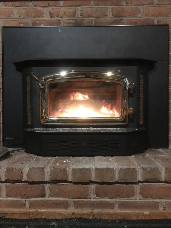

I have a Lopi Freedom Bay, an older (2008) model. We love it. it heats the first floor pretty well.

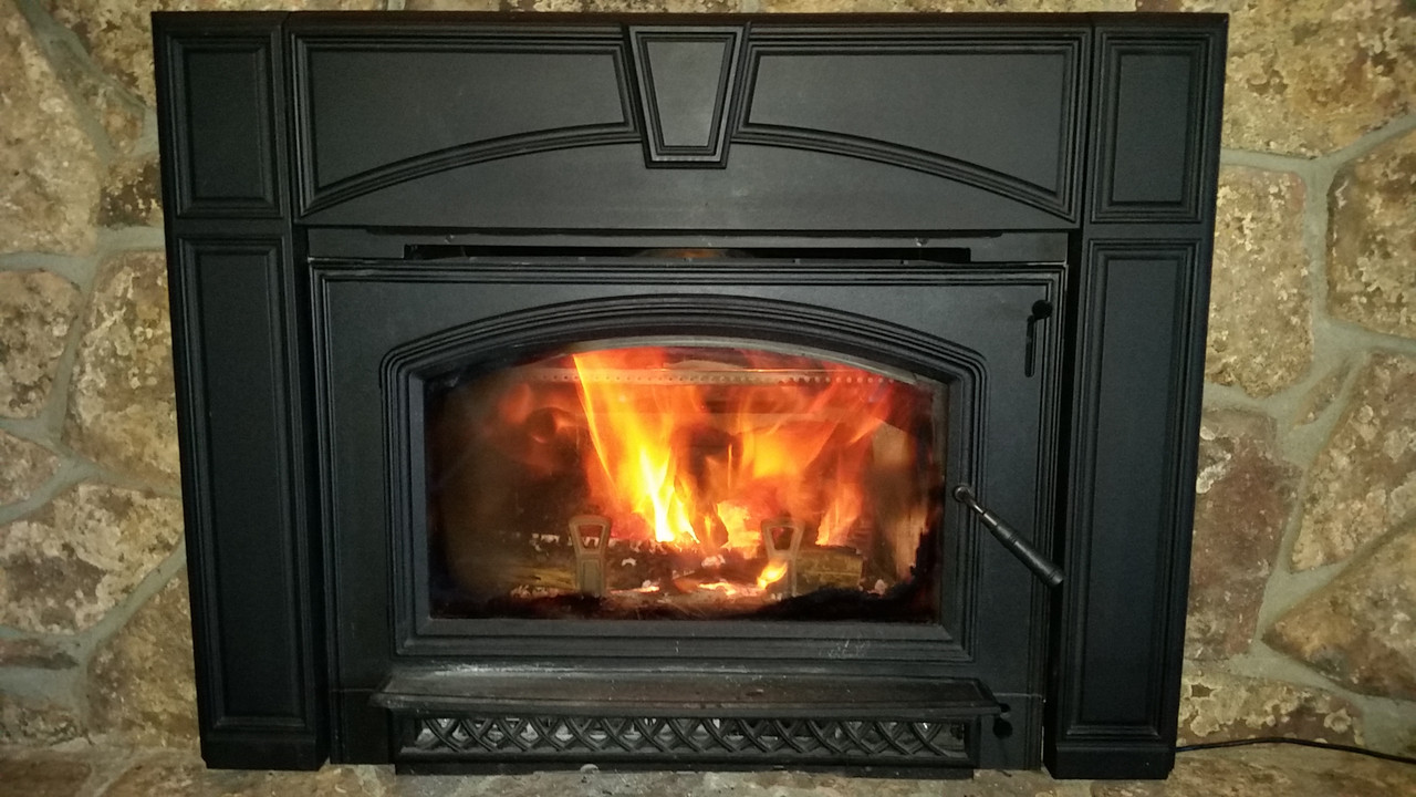

I grew up with a free standing wood stove, and I've had a fireplace insert at my current house for the past 12 years. I'm thrifty (not cheap), which means I prefer to buy used. Right after we moved in I bought a used Buck Stove (The Big Buck) made in about 1980 or so off of Craigslist (CL) for $300. That served me well for 11 years, but it wasn't very efficient and I burned a lot of wood.
I would search on CL occasionally but everything was old junk. In January of last year I stumbled on an almost brand new Quadra-Fire Voyager Grand fireplace insert for $900 on CL. They run about $3,200 new. I did a ton of research on installing it, mostly on hearth.com. I highly recommend you spending a lot of time on that site before buying.
My Big Buck had an 8" vent, and the Voyage Grand uses a 6", which is much more common. Get a stainless steel chimney liner. I installed a block off plate, rockwool insulation at the top and bottom, and I insulated the entire run of liner. All of this I found out by reading the forums on hearth.com.
I will say, IMO (and others on hearth.com) you'll get more heat out of a free standing stove than an insert. Due to aesthetics, my wife would never let me install the free standing unit. I run my insert about 20 hours per day, for at least 6 months of the year. I can't be bothered with getting up in the middle of the night so the automatic fan shuts off about 3 AM or so. We have natural gas heat, so I just run the stove to keep my bills lower. I have some air leak issues I need to address, but those are in a long list of other projects I have to do. If I stuff it completely full of wood it doesn't burn quite right, and I am left with big chunks of charcoal in the morning. I just fill it 90% or so and let it go out at 3 AM.
