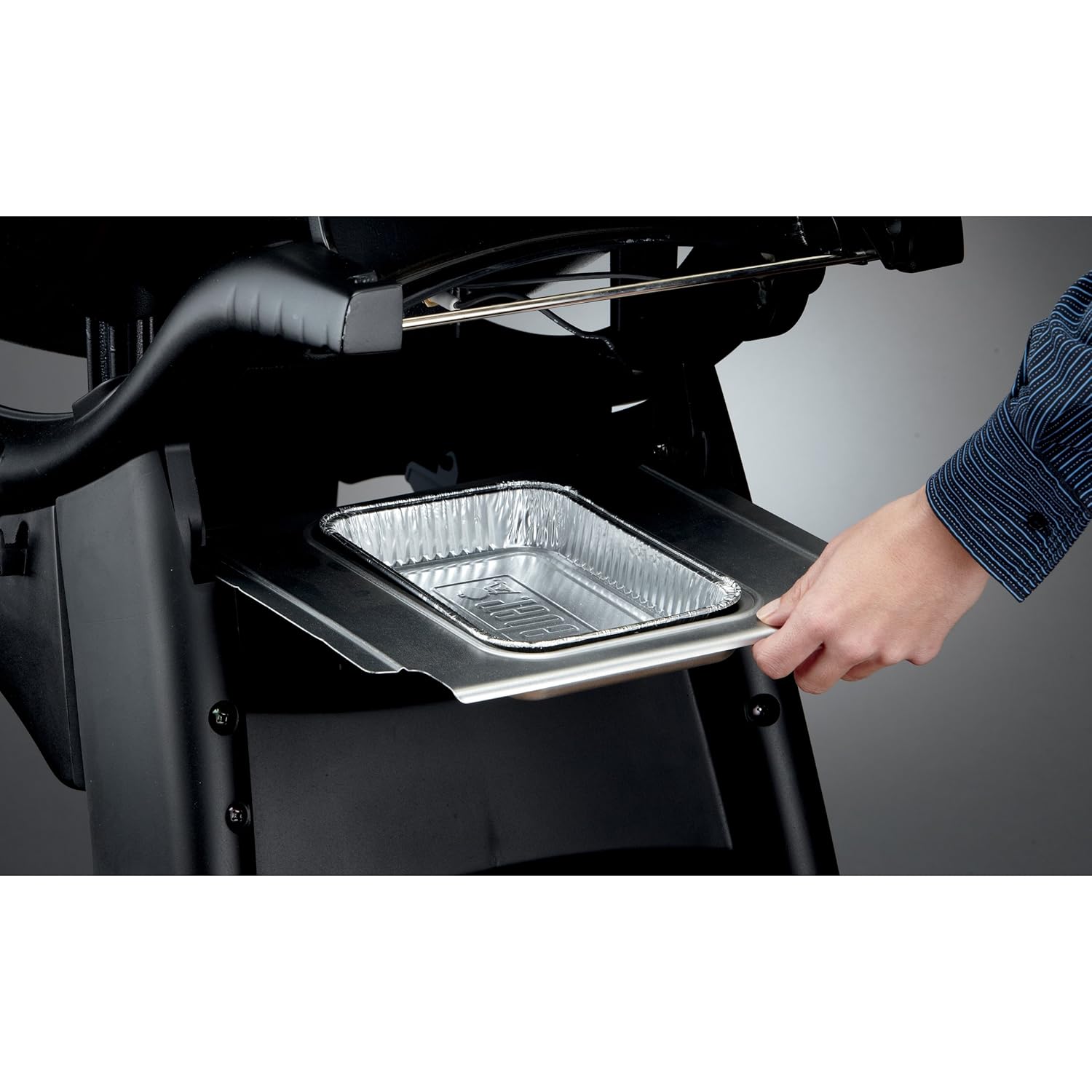

The aluminum grease tray on my gas grill has become perforated and is leaking to the ground even using the throwaway aluminum pan liners. I went to order another this morning but no joy.
Since I can't locate a replacement anywhere to purchase, even from Weber themselves, there are a couple of pinholes I need to seal.
I wonder if JB weld would work? Also considering high temp silicone. It will hit about 600 degrees maximum, maybe 50 more in the heat of summer.
The tray is formed to slide into slots to hold it under a Q300/320 grill chassis, so I can't use a generic tray. I guess hot enough particles fall down and burn a pinhole through the aluminum. I clean it with every use so it isn't old stuff burning through. Maybe the fact that it's clean and empty is working against me here? I was considering possibly cutting a flat piece of aluminum stock to conform to just the flat bottom, and adhering/sealing it with silicone, so that it's water/grease tight. Plus thicker should help.
Any ideas out there?

Picture of 83v45magna
I never would have thought of that. I think they surely would, but I would still have to seal where they mounted through. Since this doesn't need that strength, sealant or maybe even JB weld would be good. I'll have to make a nice bead so it can be cleaned easily.
I'm just afraid if I try to just repair the holes, instead of the entire bottom, I'll have to deal with this again.
While I'm usually onboard with building stuff like a tank, steel has no place here for two reasons: inferior heat dissapation and most important, rust. I have considered cutting the vessel portion out and riveting in a heavier aluminum pan. If I went that far (doubtful), I would rivet in a drain that attached a small clip to hold a standard tin can. Then I wouldn't be buying their special little disposable pans anymore either.
The one I have has two pretty tiny pinholes and otherwise looks pretty new.
Originally posted by c1steve:
Pinholes mean a larger area is very thin. I would buy a piece of 5000 series aluminum and make a new drip pan.
5052 does not corrode in saltwater, so should be good for a BBQ. Ebay sellers would have a pretty good selection. The material is easy to form and cut. Buy something the same thickness.
I wonder though, would there be some problem if I used 1.6" thicker? Ebay sellers seem to pretty commonly have 1/16" 5025 sheets. My pan measured 1.00mm (.0395") or roughly .040". 1/16" is a tad over 1.58mm
I found an almost perfect piece, 5" x 8" x .040" thick. I should only have to trim one short edge and round the corners for it to lay flat. $9.50 shipped.
This was my resolution earlier today. Buy a sheet (thank you for the specific materials recommendation BTW) and cut it to fit the bottom of the pan and attach it with high temp clear silicone, making a nice bead adhered at the edges so water probably wont migrate between the sheets and corrode further.
I found the replacement part finally but it would cost around $28-30 shipped. Plus I'd just have the same fallible part I had before. Since I already have some nice aluminum specific trimmers, this repair will likely cost about $10 total. I also see this as an upgrade, better than original.
Thanks to everyone for their help. This likely will not be a very pretty repair so I'll likely not post any pics. I do need to find a new photo hosting service so maybe.

I'm having trouble picturing what you are trying to glue together, but if I where repairing the drip tray on my grill or fashioning a new one, I'd use blind pop rivets. Unlike regular pop rivets the hardware store carries, blind pop rivets have a closed end.

I wouldn't rivet it as all the metal is going to be thin.
Hi temp 2 part epoxy would be your best bet (short of having a welder weld an aluminum sheet on top of it. Hi temp RTV would be another fix. BUT, you're going to have to get it immacuately clean of grease for them to stick.
There is a Yuuuge picture above, but it's essentially a tiny aluminum casserole pan shape with a giant rim. The bottom has a couple of small holes. I will cut a new piece of .040" thick 5052 aluminum to lay flat in the bottom, and be adhered to the original piece (the one with the perforations). So I should still be able to put the little Weber disposable pans in it, and remove and clean it as they originally planned.
Yeah no rivets.
Acetone should clean both pieces 100% free of anything.
The inside of the lid thermometer goes to 600f and in hottest weather I got it a little higher once, maybe 650f. The pan sitting underneath, would have a hard time getting much above 300f. Far less I would think under most typical use. I think most RTV is ok up to 500f, so I will go with that. I want to make a nice bead around the edge and be able to seal well enough that I don't trap much in such a way as to make it hard to get clean, or to have a layer of water. I have a theory that I should have had water in that pan to keep new holes from burning through the aluminum. So I'll likely try that out this go round.
I also want to use clear silicone since I think red or black will wind up looking like hammered excrement. It's traditional and historic of my use of glues and adhesives that I WILL make a mess of this. I really don't want or need an RTV rendering of my thumbprints on this in red or black to remind me of my ineptitude every time I pull this out of the grill. Big Grin
Discussing silicone, I am led to wonder what happens to regular, no high temp silicone at around 300f?

It burns and stinks to high heaven. I'd still recommend a 2 part high heat epoxy over silicon. You can still form a nice bead around the edge with a wet finger.
