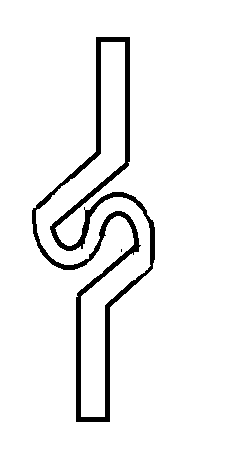

I have done similar using two 45 degree slip elbows and two p-traps.
Install and loose connections, then get it all aligned and start tightening incrementally.
Used a "skirt" around the basin.
(pardon my poor drawing)
