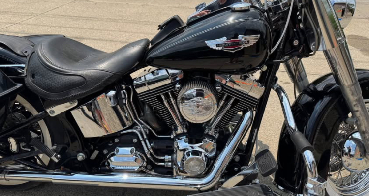

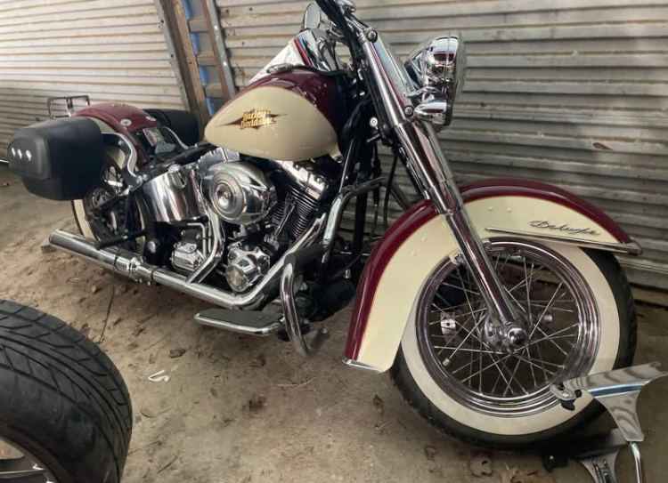

I like the Heritage Softail Deluxe but don’t know which years are best or what other models are similar and possibly better.
The HD’s that look like these are the ones I find tempting.

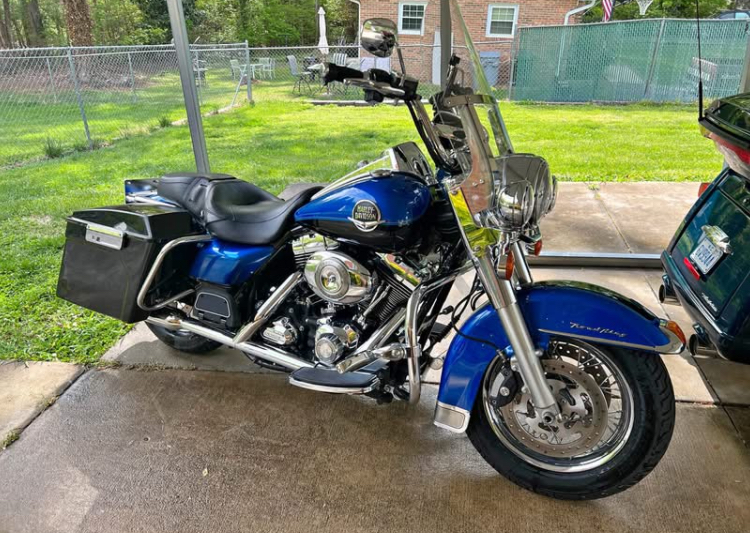

Personally I prefer Road Kings, like the blue one in your first image over Softails, only with cast wheels which gets you tubeless tires. I'd probably focus on 2009 and up because 2009 incorporated some major improvements for the Touring line which include the Road King family. Some of these improvements include a new stronger frame, exhaust system (they sound nice stock too), wider wheels, suspension, etc., and by then they were using the 96ci motor which had the new hydraulic tensioners and brembo brakes that really worked well.
I bought a new Electra Glide Standard in 2009 and was pleasantly surprised how well it handled and braked, at least as well as the 2001 GL1800 I had prior, and it was more comfortable.
Like you I always admired Road Kings so bought one in 2015. For 2014 Harley improved the 103 motor now referring to it as High Output with changes to the cams, compression, compensator, and a few other changes throughout the bike and referred to the changes as "Rushmore". It would be the last (and best IMO) of the Twin Cam series. This RK was essentially the same as an Electra Glide only with a detachable windshield instead of a batwing fairing, different seat, and bars. Unlike the EG, on the RK the seat had me too low and scrunched forward, the bars were too high, and so was the shield. These are easy fixes on Harleys though so I just ordered the bars and seat that came on the 2009 EG Standard and put them on the RK, then cut a few inches off the shield, and it was perfect. This bike ran *very* well with noticeably more power than the 96 ci Electra Glide, otherwise it was very similar.
Stock with the shield off soon after I got it.
After changing the seat and bars.
