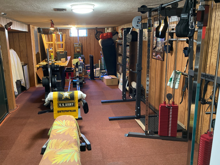

Here is the basement home gym/bar (the bar area still being a Work In Progress):
It appears well-lit in that photo, but, it's not.
What I'd like to do is add three more ceiling fixtures, the same as or similar-to the one you see in the top foreground, more-or-less equally-spaced along the center-line of the ceiling. I'd like them all to be on the same switch. (The ceiling fixture you see in front of the left side of the window in the background is on it's own pull switch.)

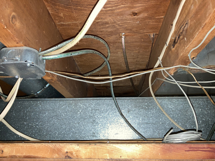

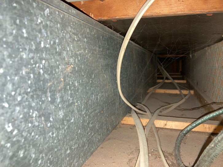

The joists run side-to-side, from the perspective of the above photo, and I do have this along the entire left-hand side:
Would it meet Code to run NM between those joists, using that "runway" in the bottom photo to get from space-to-space, thus having it just laying atop the ceiling between electrical boxes?

1) NM is permitted in concealed work (e.g., inside walls and cavities of masonry, etc.) in normally dry locations. NEC 2023 Section 334.10(A).
2) Normally, NM needs to be supported--meaning secured to the studs every so often, or run through boreholes (boreholes count as support). However, unsupported cables are permitted where the NM is fished through concealed spaces that are otherwise inaccessible. Section 334.30 (B)
So, I think what you are showing is OK, provided that the cables are protected from damage (i.e., nothing inside that space that might vibrate or rub the cable).

2) ... However, unsupported cables are permitted where the NM is fished through concealed spaces that are otherwise inaccessible. Section 334.30 (B)
That's funny, in a way. "Do it right unless it's too difficult to do so, in which case you're allowed to cheat.
And therein lies a rub (pun intended): While I could conceivably get into the "runway" space shown in the third photo to secure the NM above that cold air return duct, there is at least one run in which access to that space might not be possible.
Having the NM laying literally atop that cold air return duct is probably Prohibited. (If it isn't, it probably should be.)
I suppose I could use 14/2 BX. A lot more expensive, but, probably a lot less trouble.
I presume the BX armor has to be bonded to earth ground at each end. I'll have to find out how that's accomplished using "old work" plastic boxes.
I have to admit, I didn't read the thread because the first reply has the right answer.
Fished in cables do not need supports. If it's feasible to add them in accessible locations, do so, otherwise, don't.
Posts: 21812 | Location: Loudoun County, Virginia | Registered: December 27, 2014Reply With QuoteReport This Post
Even draped over metal HVAC air returns?
Yes. If there is a possibility of physical damage to the cabling either from pulling it or from sharp metal vibrating when unit turns on or off use common sense. Otherwise strap/staple it where you can. I used to staple entering and exiting bulkheads, but make sure the wire is not taught because you don't want the weight of 30' of wire resting against a staple.

The wires running over those boards are supported, so I don’t see what the issue is here. They needn’t be stapled if running across the supports. Even if that ceiling were unfinished, it still wouldn’t need to be stapled.
Posts: 8312 | Location: Utah | Registered: December 18, 2008Reply With QuoteReport This Post
I doubt there's any pulling issue. I've pulled Cat 5 over that same air return w/o issue. Part of that duct was removed and replaced. The only sharp edges I recall were the mating edges, and they're not exposed. I doubt there's appreciable vibration on the part of that ductwork--if any.
So I guess I'm GTG to just going ahead and pulling NM *shrug*
